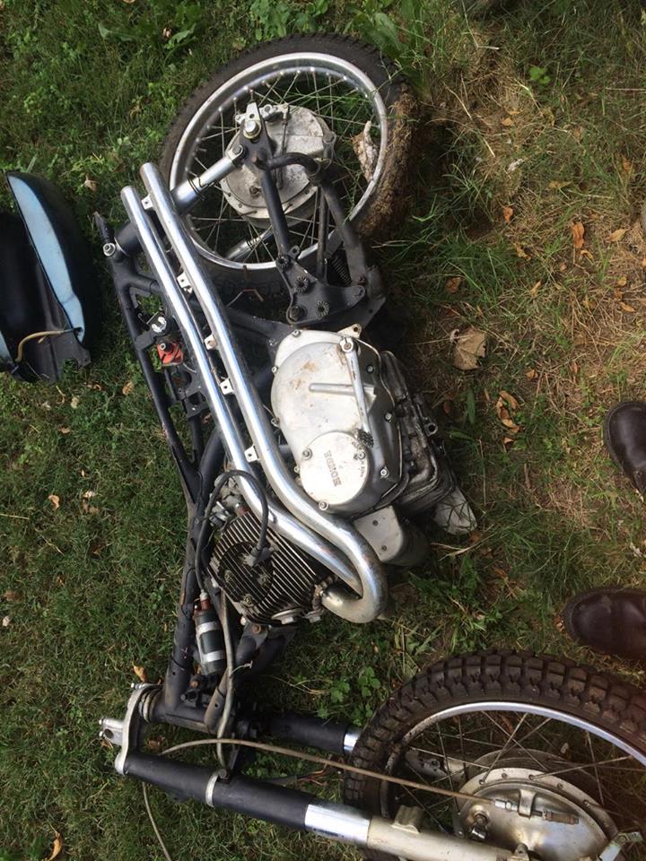

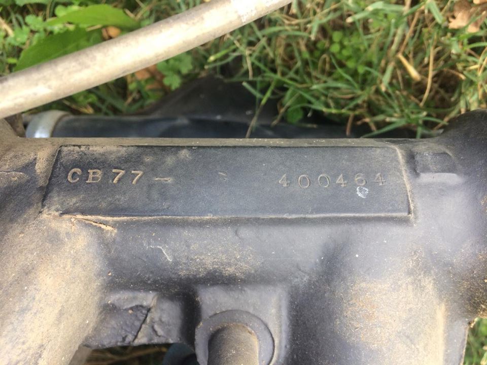

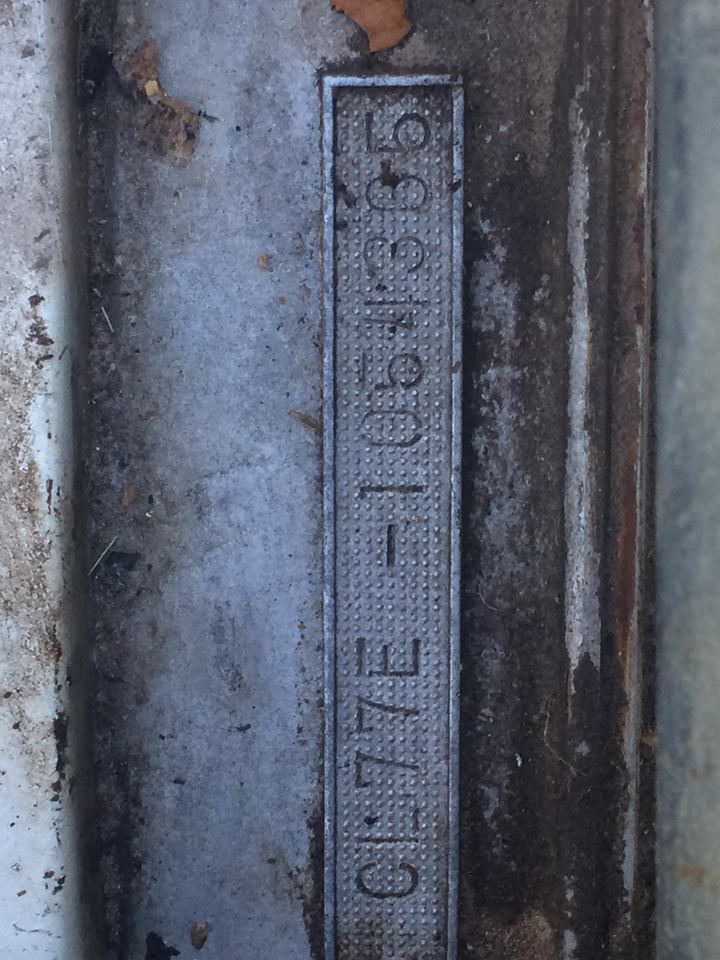

Hi, Newby here. I am wondering if anyone can tell what i may have. Frame ID is ..CB77-400464 Motor # is ...CL77E-1054305

Looks like you have a 1964 CB77 Super Hawk frame with a 1966ish CL77 Scrambler motor/exhaust transplanted. You also have the later type II forks that would not have come on a 1964 CB77. You've got a mutt, a loveable mutt none-the-less.

Well, i haven't bought it yet! The guy wants $600, and there's no title. I'm not certain it is worth a restoration with some pieces missing. But, there is a tank,and some other parts in boxes, so....
Thanks !
