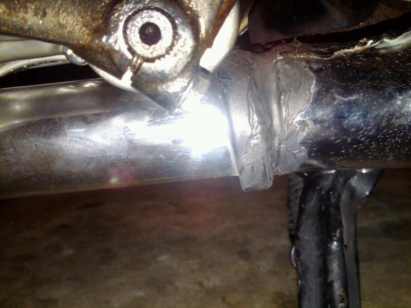

Here's a close up pic of the muffler attached with some kind of goop. I'm afraid of what's going to happen when I take it all off. How does the muffler attach? It looks like there's a metal ring and I guess the orange gasket would go between the ring and the muffler. Does the metal ring screw on?

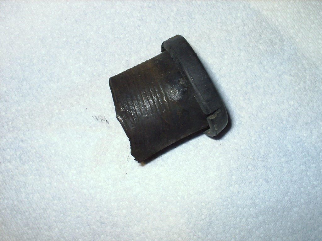

Post by ironangel » Wed Jan 25, 2012 9:29 pm
the black seal in the pic came out of my 62 dream, no metal rings or flanges. Looks like Kigsby's po plastered over hers with some kind of epoxy or what ever...jk

Post by G-Man » Thu Jan 26, 2012 2:32 am
Kigsby
Your picture shows the later type with the ring on the end. The red sealing ring fits inside this. There is nothing to 'attach' the muffler to the pipe just the rubber ring between them. You are fine to pull off that goop once you have a new seal to put in there. :-)

Post by LOUD MOUSE » Thu Jan 26, 2012 2:52 am
We'll all have a better idea what's actually there if ya take it apart.
Sort of looks like ya have the black sleeve there ta me. ...............lm

Post by G-Man » Thu Jan 26, 2012 4:42 am
LM
I have looked again - you are right. The muffler has a plain end and the rubber seal is duct-taped on.
