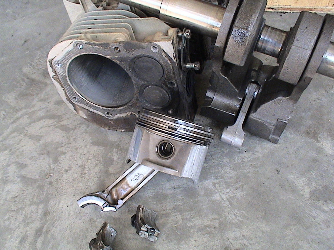

I always try to help a neighbor out on anything mechanical if I can, and keep it cheap.
It's out of his favorite "rough cut" riding mower from the farm.
Not too optimistic about this one though....
Don't think this one is worth fixing???

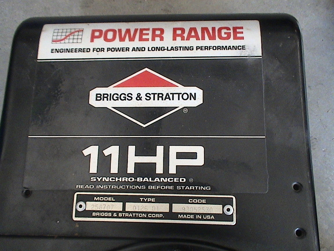

11 HP Briggs & Stratton, 48lesco where are you?
I agree, Briggs motors are usually pretty tough, but I think a rod bolt loosened and caused this one.
It had plenty of oil in it, and the owner is a stickler for maintenance on his stuff.
Several years ago I had a smaller Briggs push mower motor lose a rod bolt completely and found it laying in the case, with the u-shaped cap bent severely, and the other bolt good and tight.
No other damage.
A few taps back and forth with a hammer on the cap till the clearance felt ok, and it ran fine for years after.
Not this time..one bolt broken in 2 and the other severely bent
No other damage.

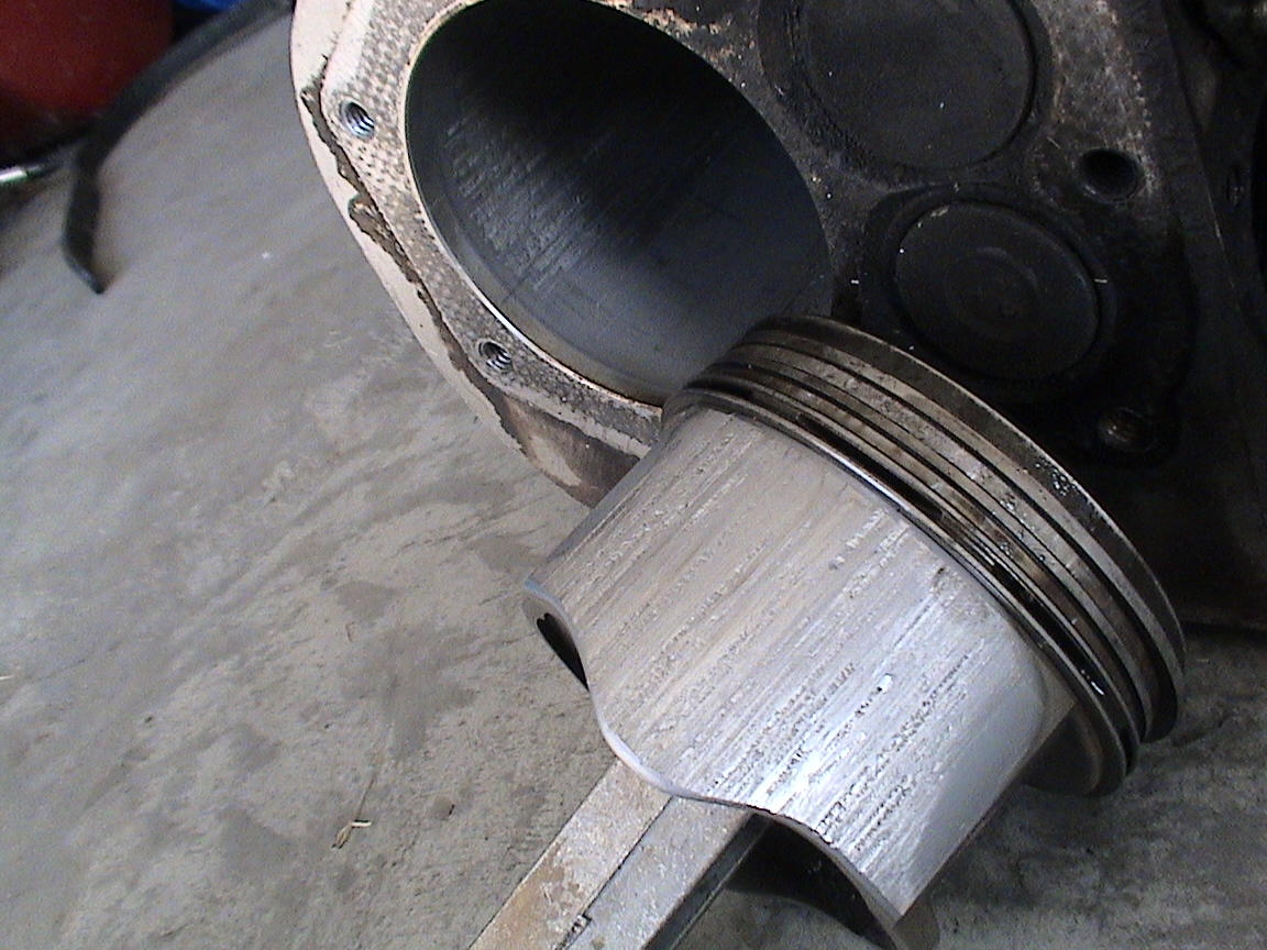

Brewsky - I'm here for you!!! Sorry - just noticed your post and no, don't fix that. Definately starved for oil but that doesn't mean it was low on oil. Those motors only had slingers, not pressure-fed lube systems which seemed to me like a corner that Briggs shouldn't have cut. What you have there can happen if the engine was run at the wrong angle for a length of time, or if the slinger/governor gear was damaged. Anyway, not Briggs finest hour. Hope you found a good replacement for your neighbor.
Thanks 48,
Yep, too scored for bore job and replacement parts are high.
Local repair guy had 3 whole running mowers for less than a short block.
He did say I had some good parts, though!
