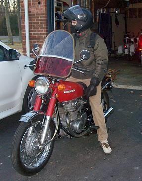

Post by m13 » Fri Jan 23, 2009 8:33 am
A warmer 27 degrees this morning and he's off to school. I hope to be getting back to my daily ride (vespa 250ie) soon. the arm is comming along SLOWLY so not too much longer. Thanks again
