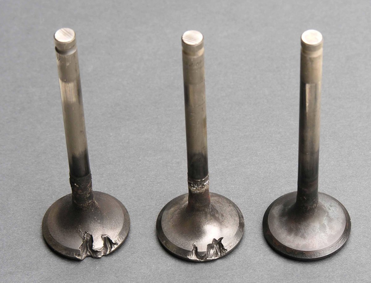

Replace the valve with the severe pitting, before the pitting gets worse.
Rebuilding an engine is to replace everything what is not good or what is out of specification. Sometimes you get away when the part doesn't have a really important function but a severe pitted (exhaust !) valve is definitely an important part, there are no back doors, it's a little time bomb in your engine.

A pitted exhaust valve leads to glowing / burning around the pitted area. In the picture below you see the results of that. Another thing is that the heat won't be transferred to the sealing area, leading to heat build up in the valve stem, destroying your valve stem and valve guide. All just a matter of time.
