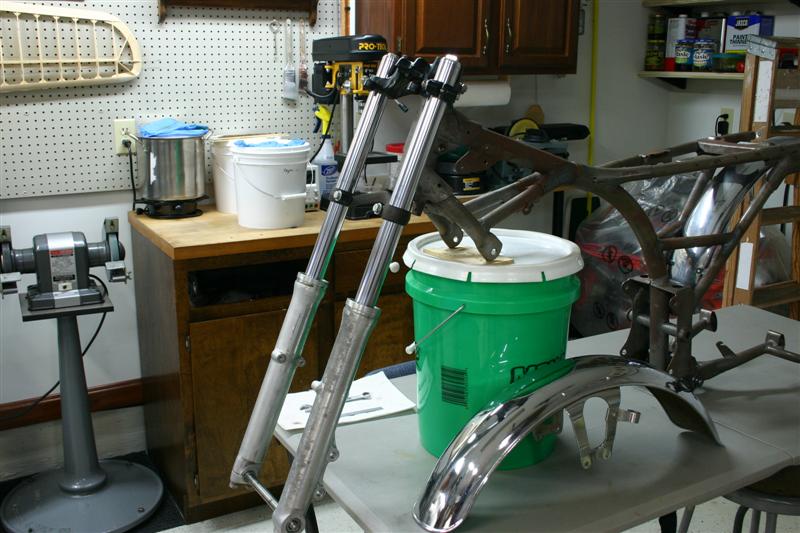

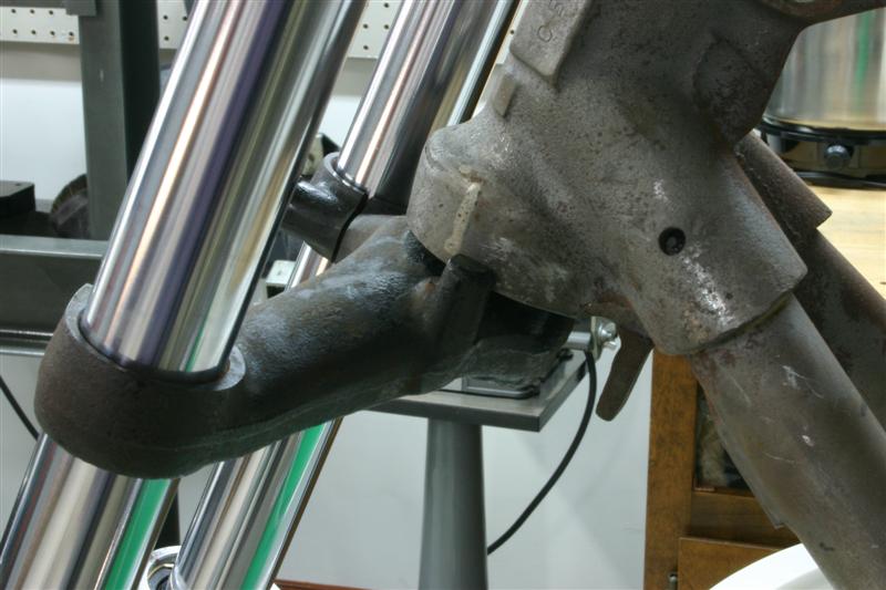

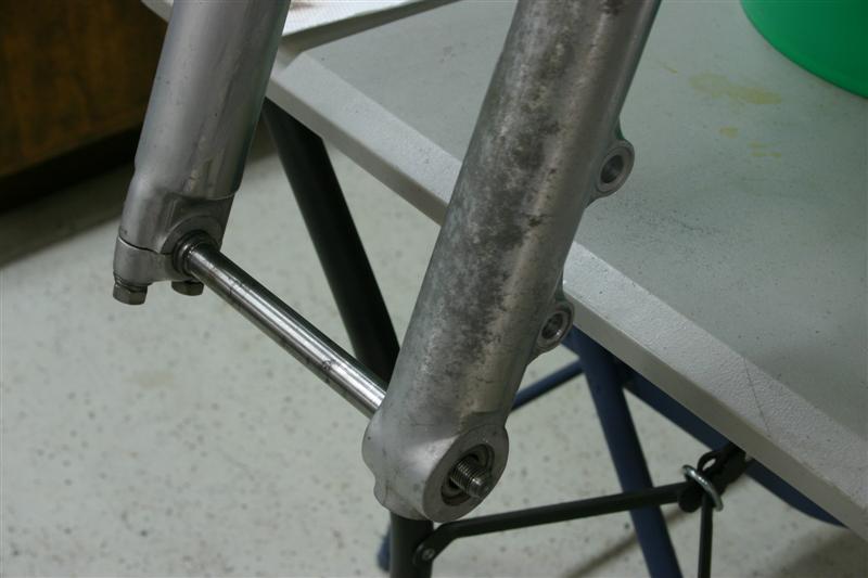

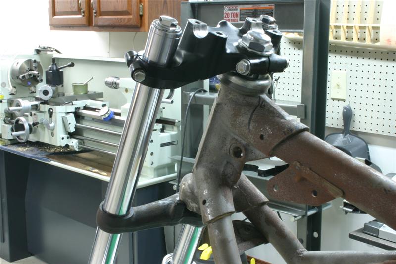

For my track bike replica, I did not want to use fork shrouds. This would leave the springs showing, as well as the unfinished upper tubes. I am not going to use oem headlight bucket, either. I wanted the 33mm tubes finished the entire length, to use clip-ons. After looking at specs on a number of different Hondas, I decided to get forks and triples from a 1979 CX500. The E-bay seller spent some time giving me different dimensions from the CX - close enough to what I wanted. The tubes have very few flaws; of course the sliders and both triples will need re-finished.
The oal of the forks about 3" longer, allowing the top of the tubes to protrude beyond the upper clamp to give me a location for clip-ons; the steering stem races, length, seal same as CB77, and the triple ass'y bolted right up; the CX forks have a 5mm wider spread than the CB, which is only 3/32" per side; the CX travel is 5.2", the CB 3.15"; the CX axle diameters same as CB, only CX uses a M12x1.25 nut, the CB, a M14x1.5 nut. As far as distance between sliders for the CB wheel, it will only be a matter of making spacers to suit. The upper triple has a provision I can use to mount my AutoMeter tach, and other mounting points for a horn.
With the forks mounted on the triples, and taking into account the travel, the axle center line is about 1 1/4" greater from the steering head than the stock CB. I can probably account for some of this with a longer rear shock, so as to keep the steering geometry nearly the same.
I will also have to make some new steering stops to accomodate the CX lower triple difference.

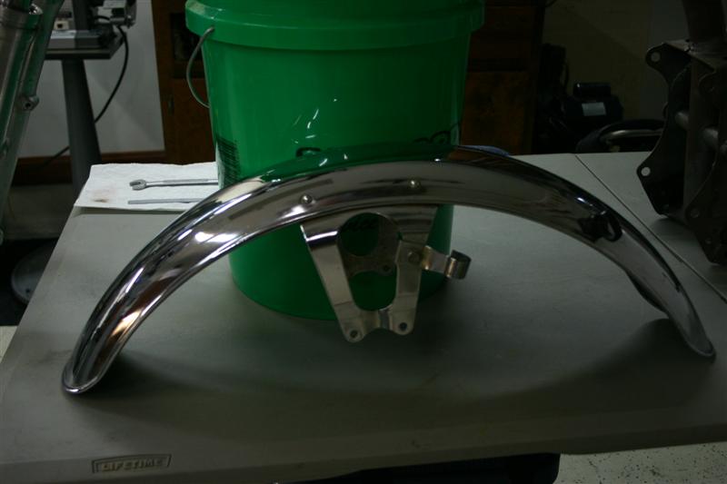

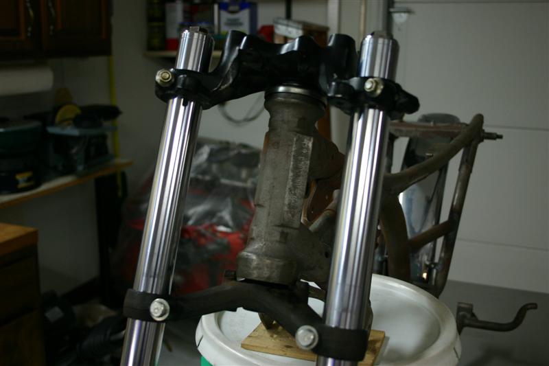

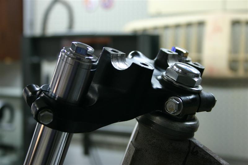

more pics. Also found a CX500D fender, a little longer than the CX500 Custom. The chrome on the upper clamp nuts very nice.
