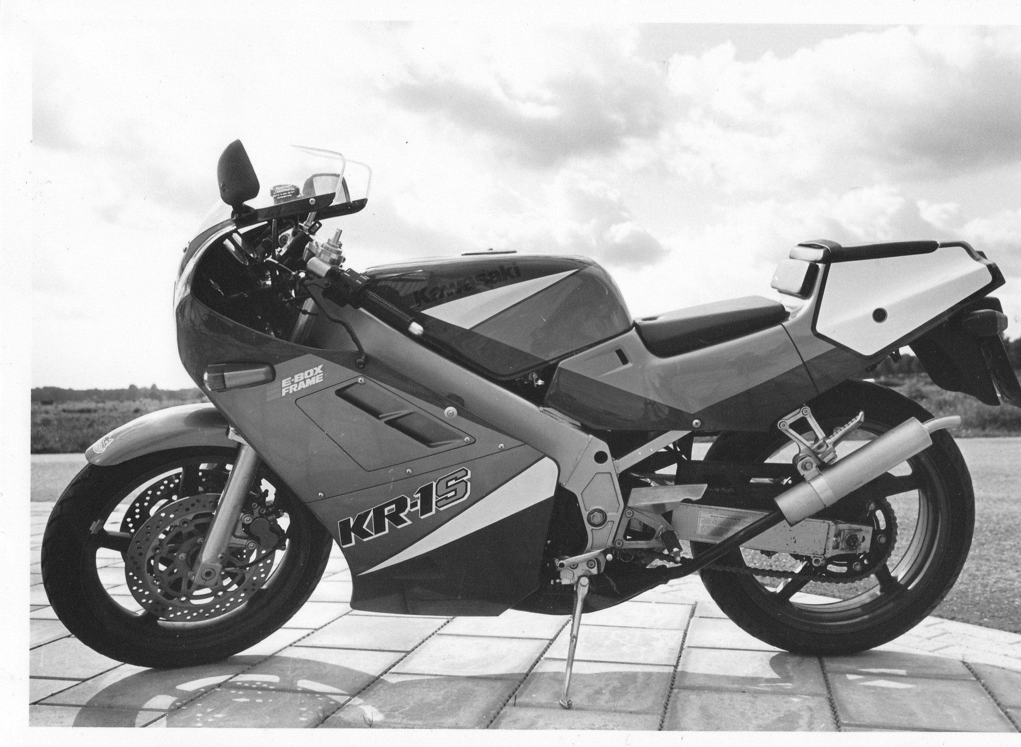

I do have a KR1-s' 89, I don't think the model was sold in the US, but it has 62 Hp out of a 250 cc twin engine, and weights only 150 kg, and that is with fluids.
It has flat slide carbs, and when you drive this one, you learn to open the throttle slowly, for different reasons, that is. The only issue with the bike is that is has many problems with keeping in one piece.
Jensen

That thing looks awesome! I WISH we got bikes like that! One of my other favorite bikes was the RD400. Again, the US got the heavily-restricted version that made quite a bit less horsepower and torque.

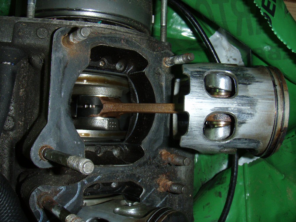

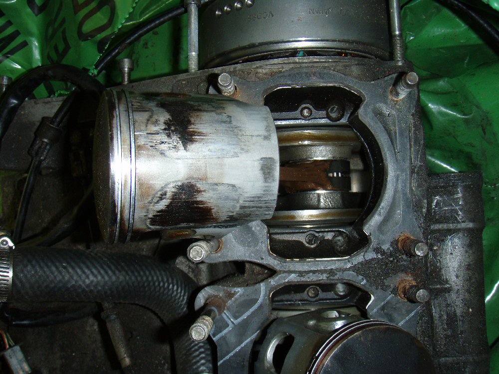

I had a RD350, a RZ in the US, and drove to school every day,
nice bike but very sensitive to weather. I did 75.000 km with it before I sold it.
The pictures shows what happens when not jetting for wintertime.
Jensen
