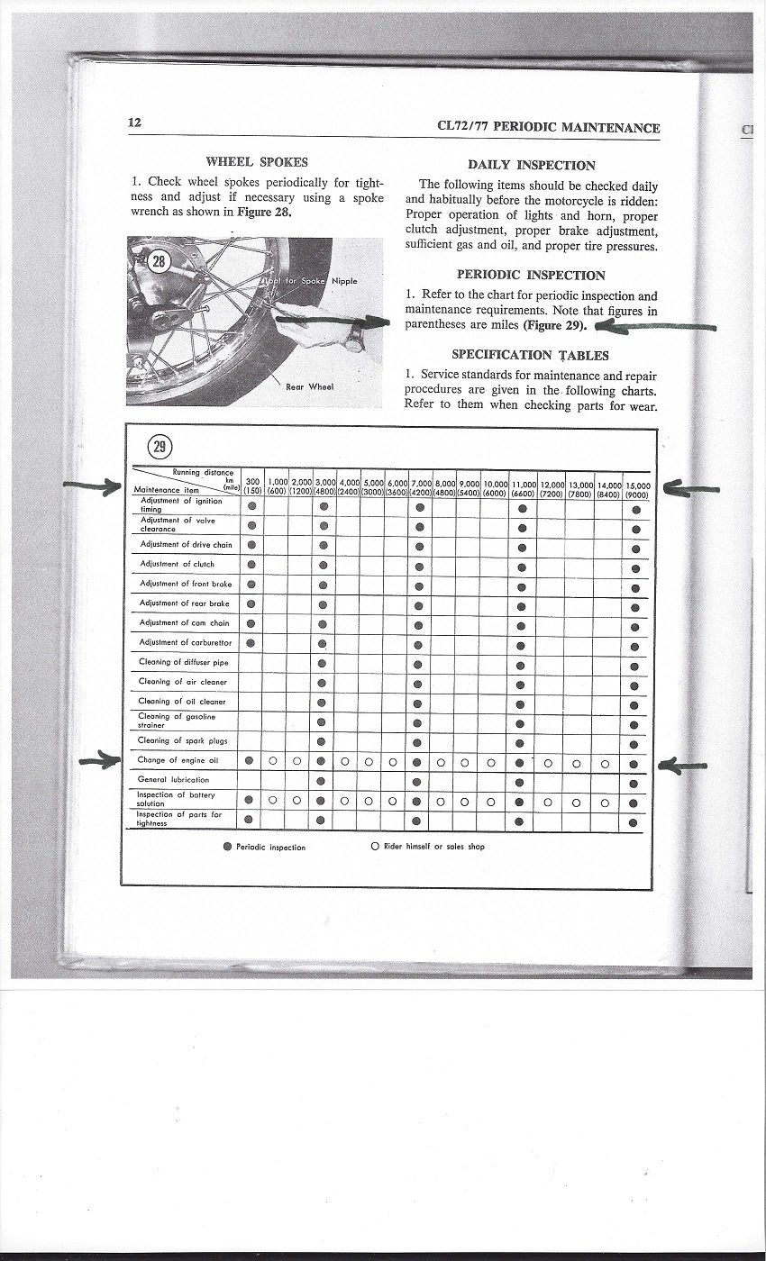

I am including the data I have which as I look at now I gave numbers which I though were in Miles and a closer look tells me the numbers were in KM.
So the numbers I give are in KM and for the CL72/77 engines. (BELOW)
Under the KM numbers are Mile numbers.
Miles start at 150 and end at 9,000 on the Periodic inspection chart.
There is an error at 3,000 KM which shows 4800 and near as I can tell should be (1800).
As I read this info I see oil changes and all other inspection items are at a 2,400 mile interval after break-in.
I've seen yours and here is what we here in the USA were issued. ...............lm

Post by G-Man » Sat Sep 12, 2015 3:11 pm
Yep - agreed the 4800 is a typo and should be 1800.
From your table and assuming the black dot and white dot means the same as the CB77 manual (i.e. black means dealer and white dot means owner) I read.....
Dealer Oil change at 150 miles
User or sales shop oil change at 600 miles
User or sales shop oil change at 1200 miles
Dealer Oil change at 1800 miles
User OC @ 2400
User OC @ 3000
User OC @ 3600
Dealer OC @ 4200
User OC @ 4800
User OC @ 5400
User OC @ 6000
Dealer OC @6600
User OC @7200
User OC @7800
User OC @ 8400
Dealer OC @ 9000
