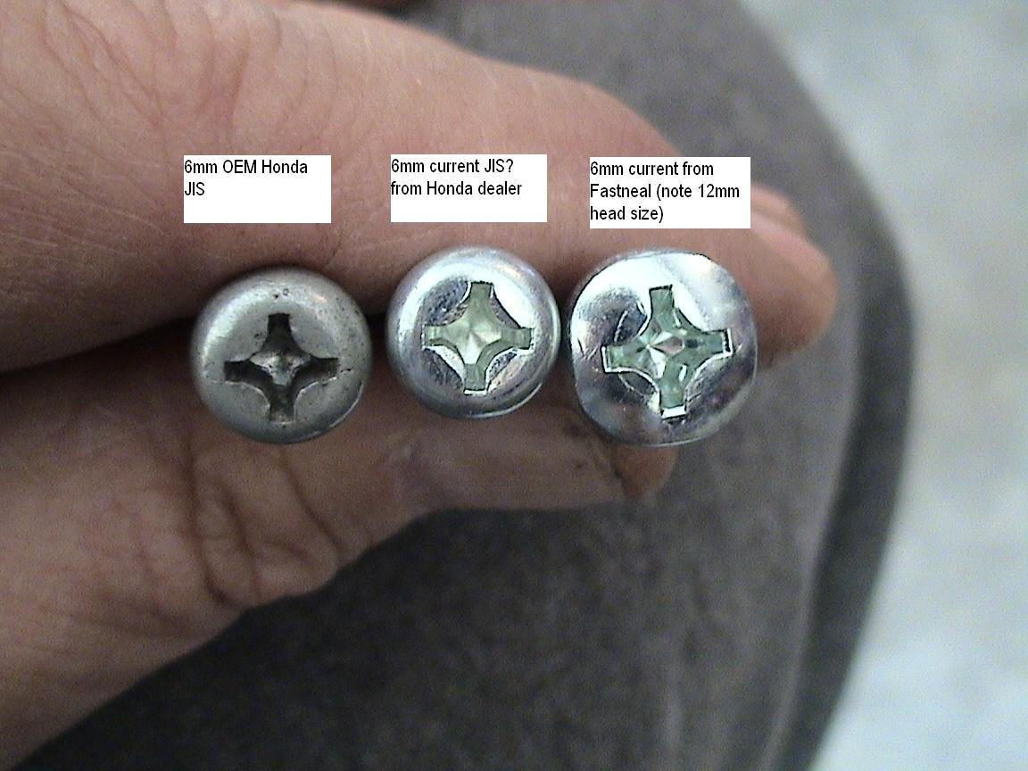

I agree that especially the 6mm screws don't look like the perfect 90 degree cross pattern for whatever reason. Even the McMasterCarr JIS drawing doesn't look like it, but it is clearly labelled JIS on their web page and different from their non-JIS drawing.
The obvious difference seems to be the head sizes. (10.5mm for JIS and 12mm for current standard metric).
I think there has to be some additional distinctions such as differences in angles and dimensions within the relief cuts, but without the detailed manufacturing drawings who knows for sure? Surely the "designed to cam out" distinction is more than a simple radius difference?

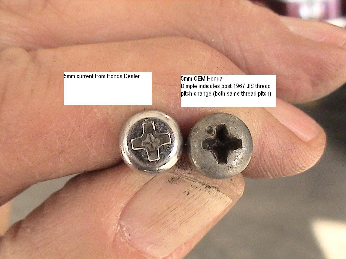

Some additional food for thought in the pics attached. Note the 5mm screw with the dimple is definitely JIS, and it does not even have the perfect rectangular cross. The screwdriver tips do show some subtle differences.

Like I said, the smaller (ignition cover screws) are more like someone could expect compared to the drawings. But the 6 mm, like you also show in the pictures, doesn't have any signs of rectangular edges, which are so significant for the M5 and smaller screws.
How is it possible that, when both are designed and manufactured from a JIS drawing, the 5 mm and 6 mm screws are completely different ?
After all, we all know that JIS means Japanese Industrial Standard, the word standard is controversial when looking at the 5 and 6 mm screws.

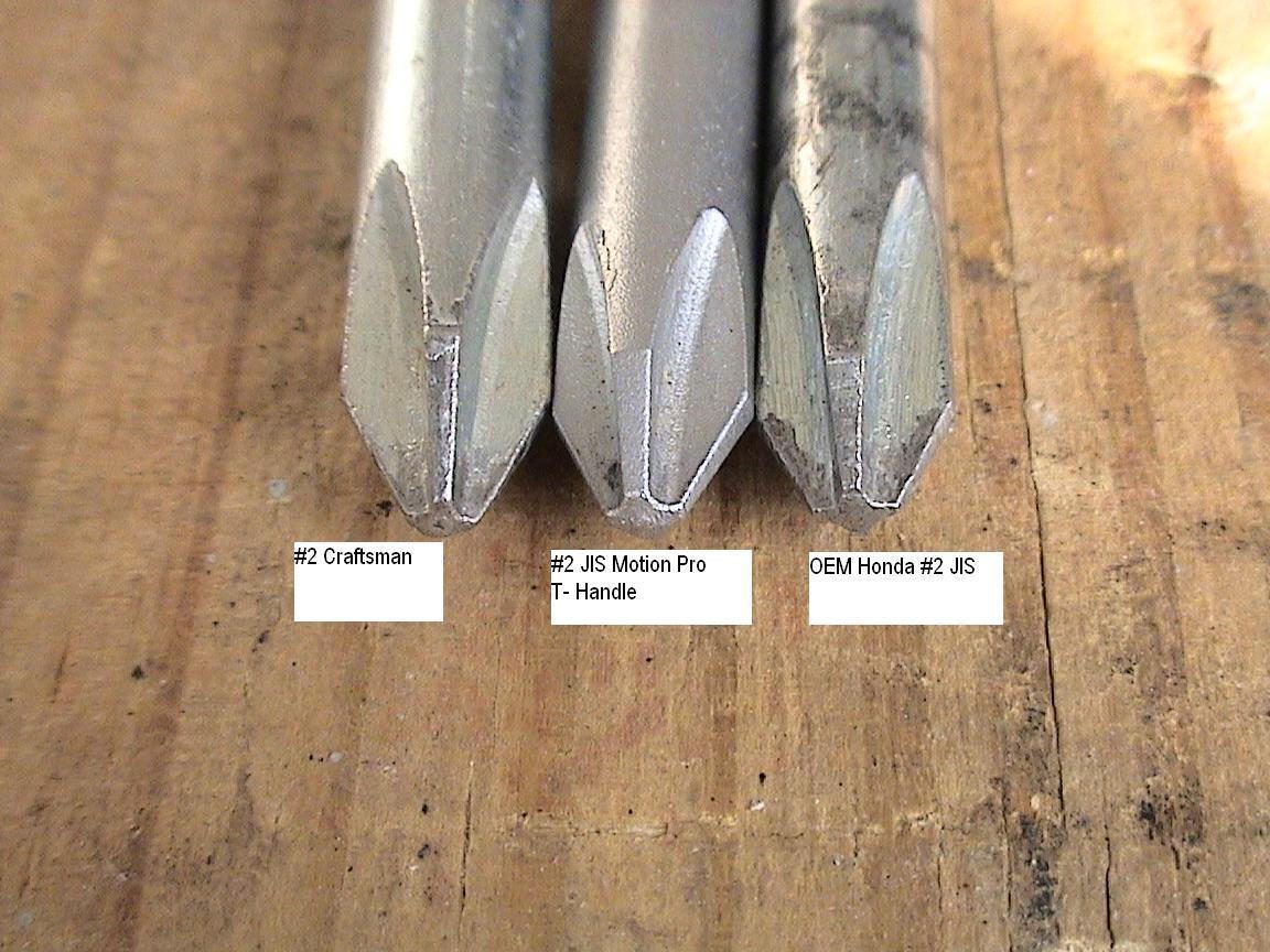

In the pictures you have posted I think I do see important differences. Start with the screw drver tips. The circumference of the screwdriver shaft seems to come down farther on the JIS vs Phillips. The very end of the screw driver tip also seems to have a bigger flat area on the JIS vs the Phillips. Either of those difference alone would/could change the angle of the outside surface that results, but perhaps there is no difference in the angle with both of them being different. But it does appear to me that the screwdriver tip goes farther into a JIS head than a phillips.
I agree with you that the well defined cross shown in dspictions of JIS head screws doesn't seem to match the reality of the screws. BUT, I think focusing on the look of the center of the cross misses the likely difference. I think the screwdriver tip going farther into the screw head and the resulting larger radius of the angled surface from center line of the screw could be what helps avoid "cam out" with JIS screws. Being farther out from center line of the screw head would give more leverage and allow more torque to tighten and loosen the screws. It would also explain why a more pointed Phillips head screw driver doesn't fit deep enough and ends up screwing up JIS head screws. The angled surface of the Phillip screw driver can't match up with the corresponding angled surface in the JIS screw head. While this would not explain why a #3 Phillips seems to fit JIS heads, maybe there is some other engineering similarity at that size that would.

Yes, excellent thread. I have been under the impression (for a very long time), that the JIS fasteners had a shallower depth in the screw head, and that a Phillips driver (depending on its quality) would bottom out at the tip before the JIS flutes would be fully engaged. By taking about .020" off the tip of the Phillips driver, the engagement in JIS fasteners would then be much more substantial. Urban legend? The Reed and Prince fasteners have more of a true cross appearance (no radius between the flutes), but also have a different taper angle, and the drivers come to a true point. Regards, Chase
