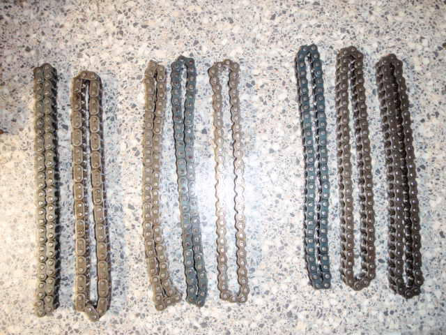

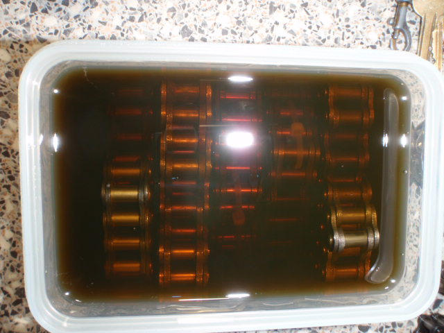

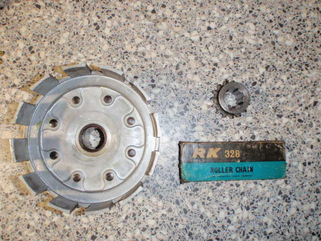

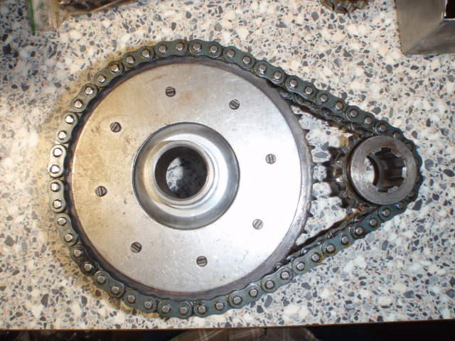

I was curious how to measure the length of the chain on a simple way, so I decided to try a few things.
After testing a few methods, I got a NOS clutch outer, a NOS primary gear and a NOS chain, and measured the max distance between the clutch outer and the gear (see picture).
I have a few NOS chains, and these were the measured distances :
chain 1 : 20,0 mm
chain 2 : 20.0 mm
chain 3 : 20.1 mm
chain 4 : 20.1 mm
chain 5 : 19.9 mm
chain 6 : 19.9 mm
chain 7 : 20.0 mm
Then I measured the distance of used, but "good" chains and found this :
chain 8 : 20.6 mm
chain 9 : 20.4 mm
chain 10 : 20.5 mm
chain 11 : 20.8 mm
chain 12 : 21.0 mm
chain 13 : 21.2 mm
I also measured a few worn chain's (the primary tensioner was not able to keep the chain under "pressure") :
chain 14 : 23,8 mm
chain 15 : 24.1 mm
I don't know if the info is useful for anyone, but it's here. I learned that the measured distance must be smaller then 23.8 mm, but is best at 20.0 mm.
Jensen
Post by davomoto » Wed Nov 03, 2010 6:23 pm
Jensen, where exactly did you take the measurements? This is great info, thanks for posting! The Fed is going to buy up billions of dollars woth of bonds, with the idea of freeing up more money for banks to lend. The problem is, after the last meltdown with the sub prime BS, bank are very picky about whose getting a loan. Only time will tell!
