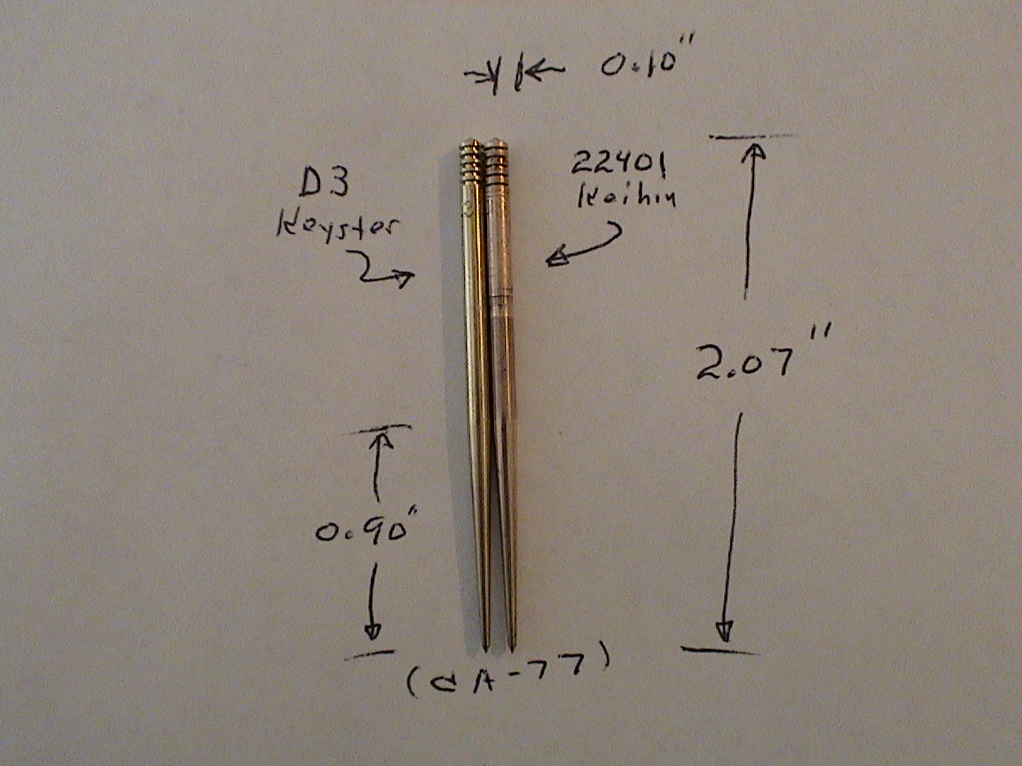

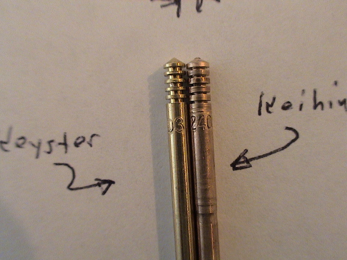

Post by brewsky » Wed Apr 06, 2011 11:07 am
Here's a comparison of the Keyster and Keihin needles for the CA77 (with needle numbers):
The only difference I can detect is the width of the circlip slots.

Post by MBellRacing » Wed Apr 06, 2011 1:35 pm
Brewsky,
I saw the same thing when I looked at my Keyster needle versus the originals. It seems the fallback excuse for my bike's poor running is the Keyster needle and slow jet. I might agree with the latter. I wish I could find my originals.
Look here, only just scanned over the info and haven't seen the original numbers to see if there is a close relative to our CB77 needle.
http://www.motorcyclecarbs.com/KEIHIN_N ... __W252.cfm

If the diameter is identical at 5mm intervals all the way from top to tip, then they are the same. Keyster needles are often quite a bit different at the tip or the root and they need to be absolutely thy same
Very small difference in diameter can make a huge difference to performance.
Post by brewsky » Thu Apr 07, 2011 4:30 am
MBellRacing wrote:Brewsky,
Notice the needles I posted are for CA77, I believe CB and CL are different part numbers.
I haven't been able to find anything in the charts or diagrams to even match the same overall length.
Also, the conversion chart assumes a 6 digit OEM mark, and the CA needle only has 5
