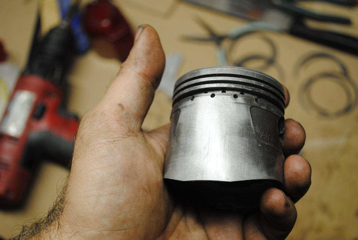

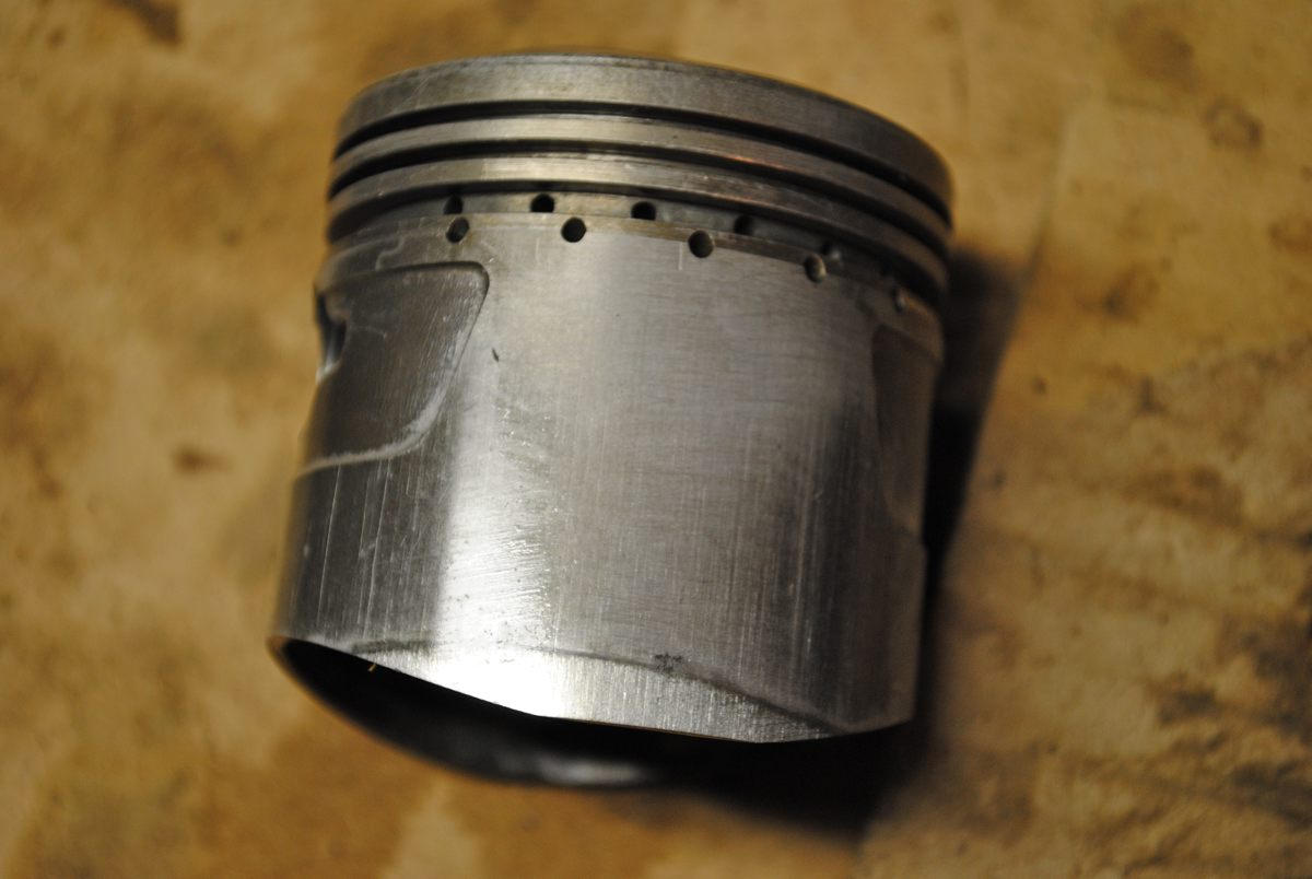

The pistons themselves looked evenly worn and free of any scratches excepting microscopic lines in their surface. I rubbed my thumbnail over them and they were not deep enough to feel. Again, I don't know how precisely they need to be measured, but they certainly were not visibly damaged- EXCEPT: on one of the piston skirts a strange discoloration. Pic attached. Unfortunately I don't know which piston this is, an oversight on my part.
Whatever the outcome, I'm ABSOLUTELY going to need some new piston rings. The top two came off with no difficulty, but the bottom ring I broke- twice! Anybody have any advice on how to remove those- I tried to be more gentle on the second attempt, but it seems they have very little give.

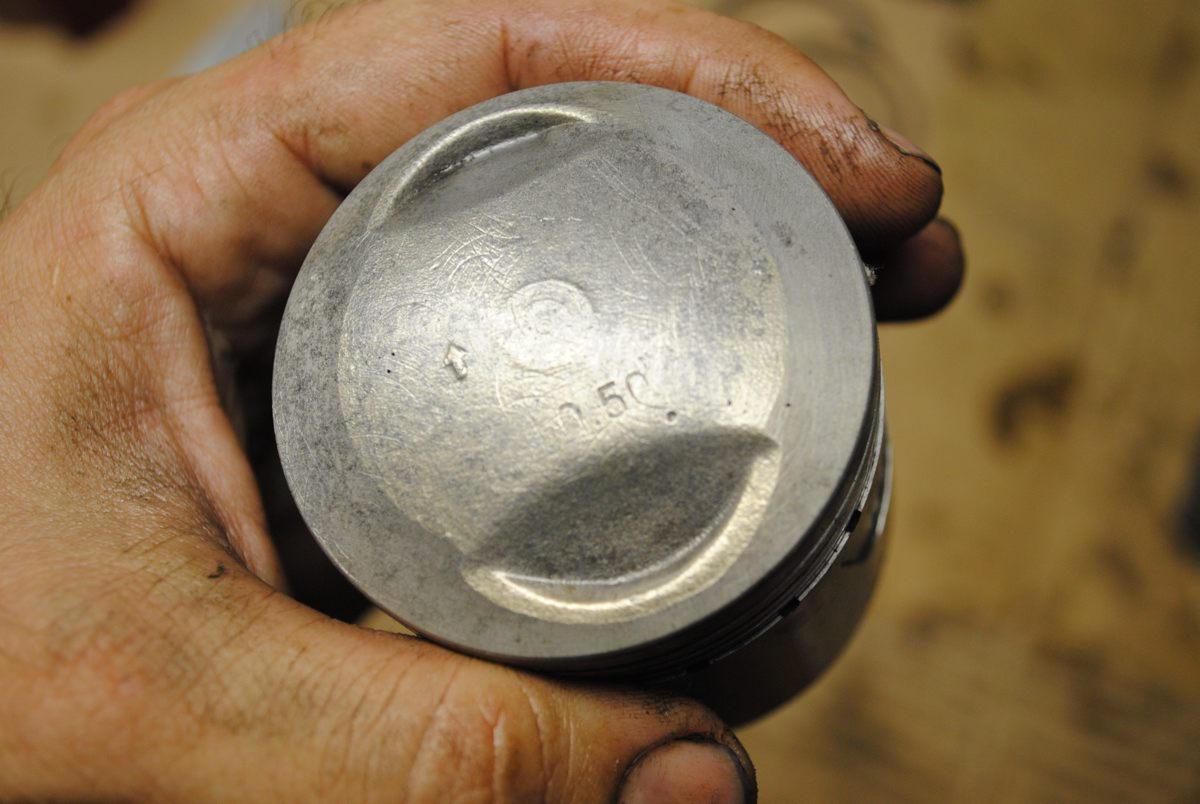

The pistons, BTW, are marked 0.50, so I assume this means they're 2 over - Not standard.

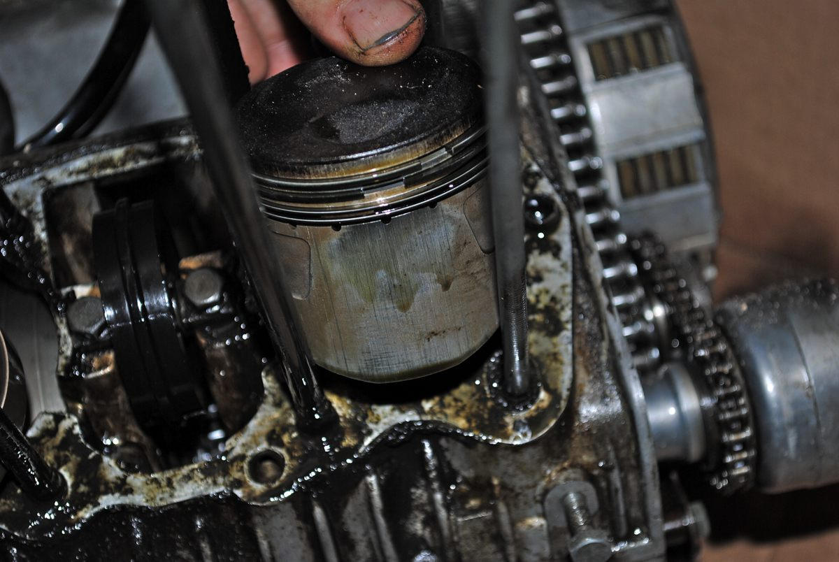

The piston that leaked. I can't say whether the ring gaps were in this position when they were in the cylinder- I likely moved them around. This is just after I separated the heads.

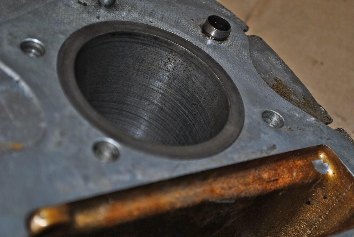

A look into the cylinders, although probably not enough to draw any conclusions from.
0.50 - is that 2 over standard?
Generally the pistons look like this- smooth to the touch and without any appreciable damage.
But what's this? Only in this one spot on this one piston.

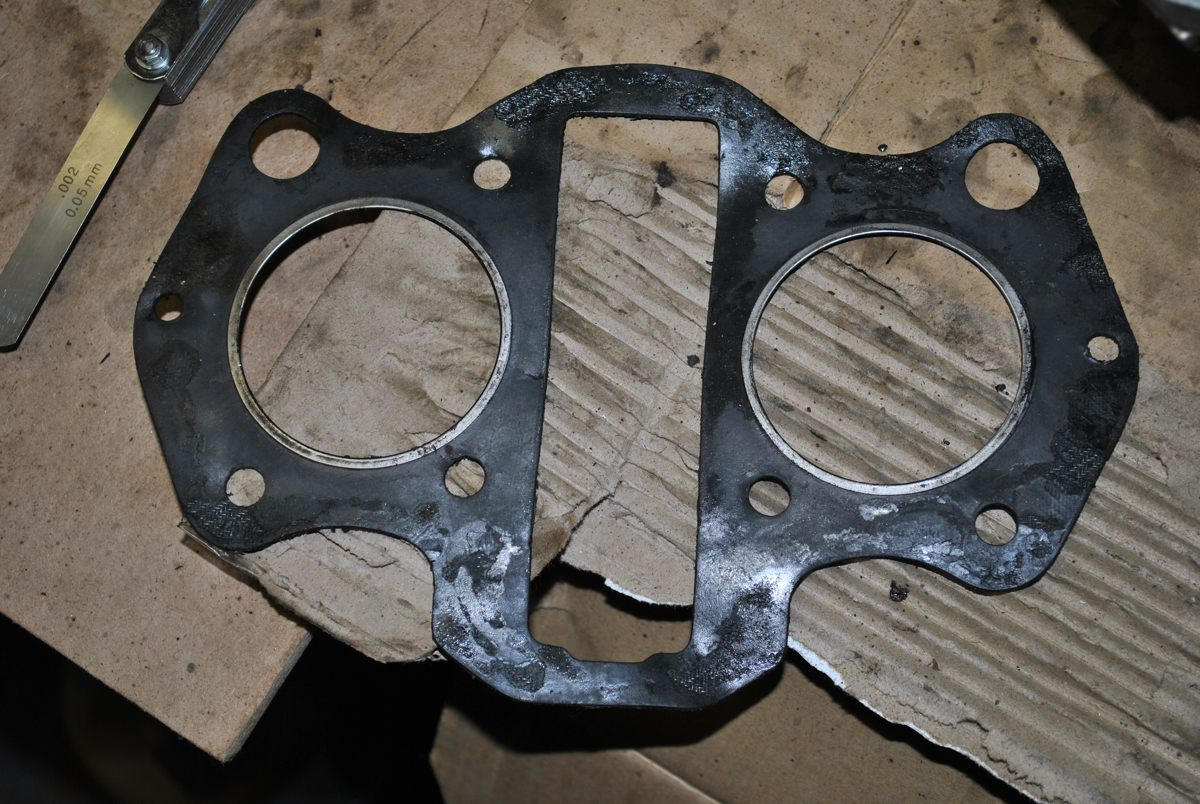

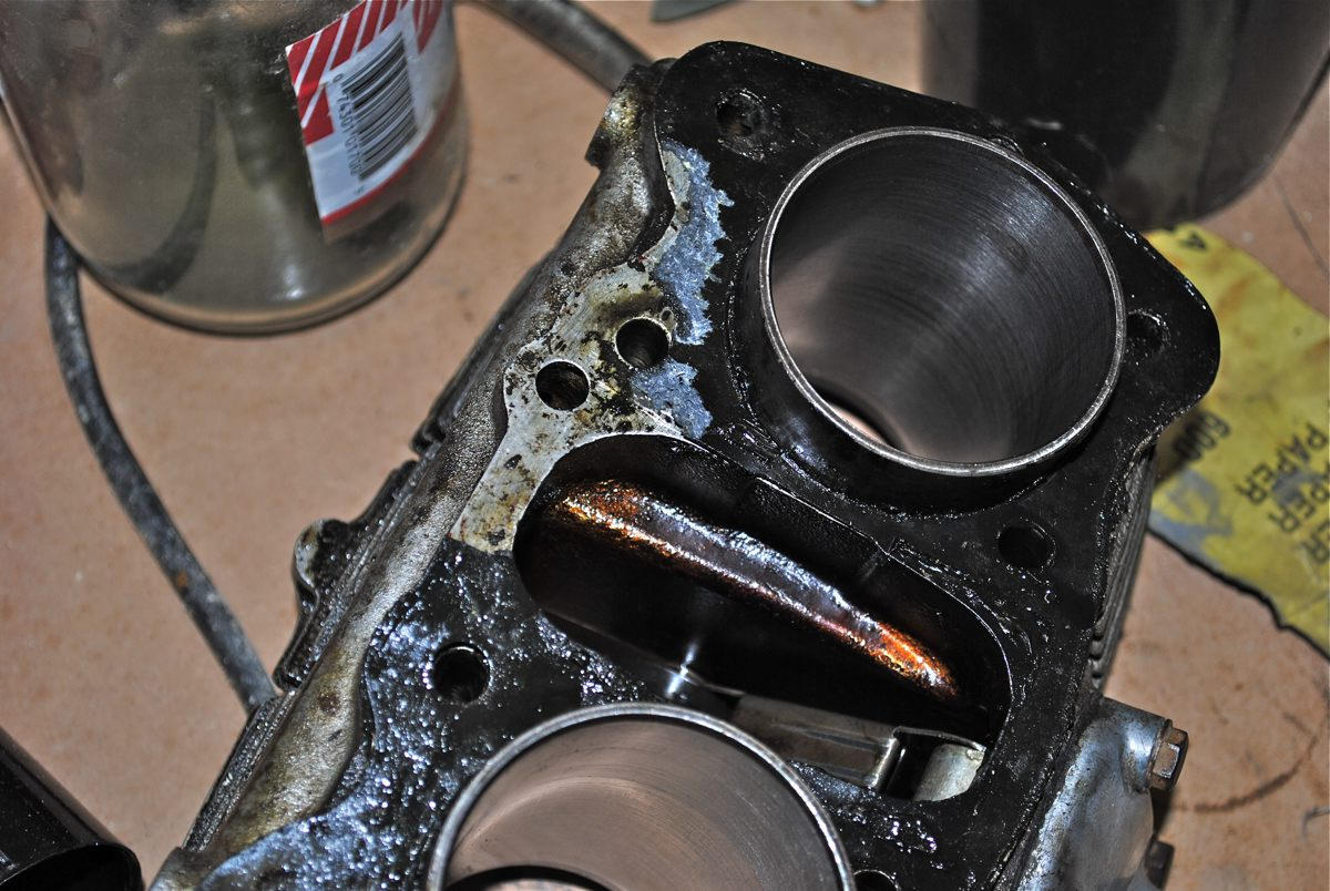

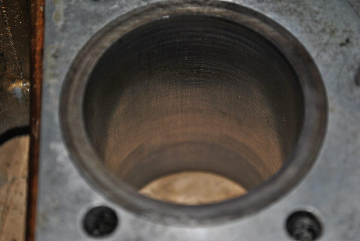

pictures can be misleading but those pistons "look" fine. the barrels look odd but that may just be the picture. Do you have a picture of the upper part of the bores and of either side of the head gasket please.
The bores should have a 45 degree (or so) cross hatch and those look like they have been bored rather than honed to size. Without good measuring tools, we have to resort to less precise means to measure.

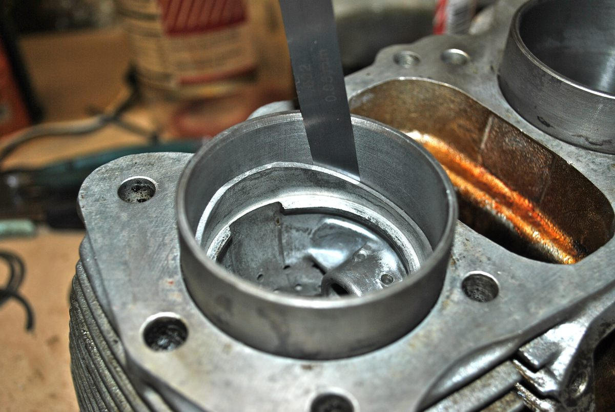

If you insert a piston back into its bore and slide a feeler gauge between the front face of teh piston and bore, how much clearance do you get. The sides are a different shape and the tops are smaller than the bottoms, so it's only necessary to measure it at the bottom on the front or back.
Just as a point of reference, .002"is OK. .005 is a little more clearance and .010" is getting sloppy.

If I'm not mistaken, the photo of the clean piston indicates ".50", which means it's an oversize piston already so you need to get the corresponding rings if you reuse the pistons.

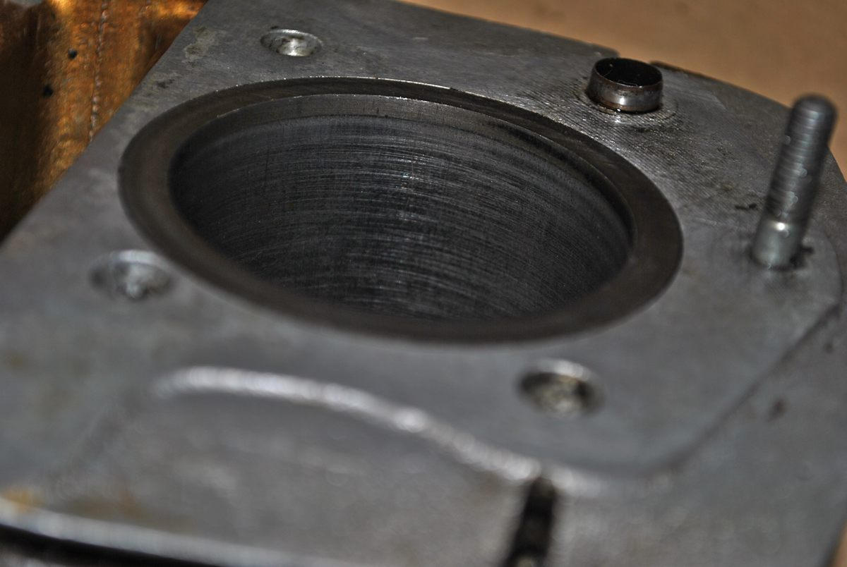

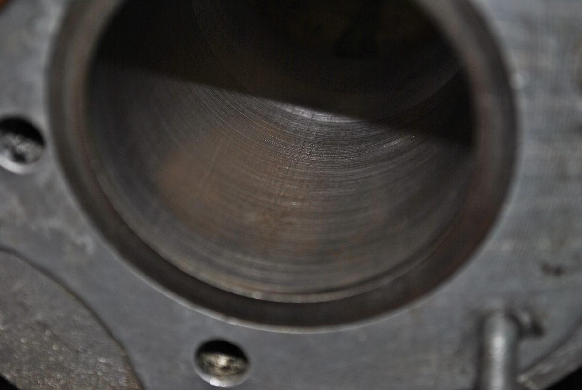

According to the pictures there isn't a decent honing (cross) pattern on the cylinder wall.
This honing pattern will hold the oil so it can lubricate the piston, my advice would be bore / hone to .75 and look for some NOS .75 pistons and rings. The (upper) skirts of the piston show heavy wear too.

So here's the latest:
As Teazer instructed, I inserted the piston back in the cylinder and used a feeler gauge at the front of the piston to measure the gap. I'm pleased to report that the .002 wouldn't even work it's way into the gap; if I slid it into the side wall of the cylinder and then moved it around to the front it still would only wedge itself in there rather sungly and resist when I went to pull it out.
The cylinders themselves have etchings going horizontally and vertically, but not a 45 degree crosshatch.
Also attaching a pic of the old head gasket per Teazer's request. It's pretty ragged since it was stuck pretty firmly to the cylinder head in places and it peeled apart in my effort to remove it.
The closest to the front of the piston I could get the .002 feeler gauge without forcing it.
hopefully these pics will give a better indication of the markings on the cylinder walls.

Pics of the head gasket after removal:
