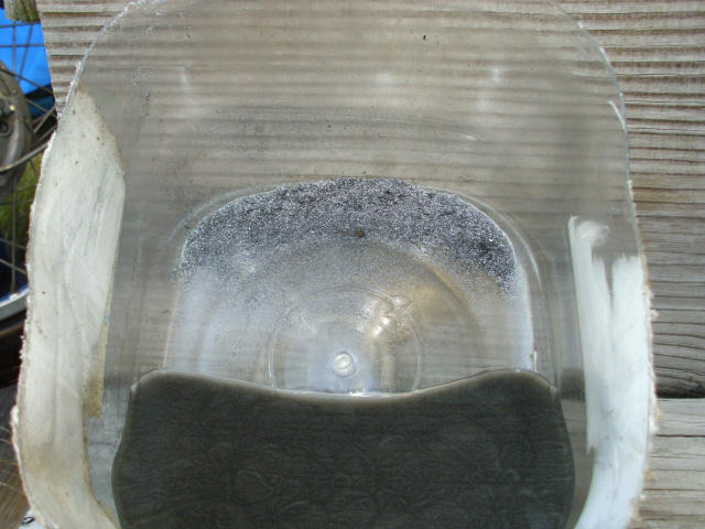

Here's a little side benefit of removing the primary case, check out the aluminum mud that came out of the oil filter!
Something very dramatic happened to that engine in it's previous life and whoever repaired it didn't even clean the oil filter!
Re-enforces my "lesson learned" about not taking anything for granted on these things.
