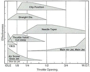

Post by brewsky » Sat Apr 02, 2011 6:42 am
You can also test the main jet by closing the choke slightly while under WOT and see if the engine picks up power. If so, your main jet could be too small.
If you test by simply closing the throttle, the needle jet comes more into play and complicates the situation.
More info:
http://www.mikuni.com/fs-tuning_guide.html
http://www.carbparts.com/keihin/needles ... r_carb.htm
Vince is dead on about the dead spot....where is it on the throttle?
The chart below can help identify the problem circuit.
If you mark your throttle with a pin or tape it will help identify where you are when it happens.
