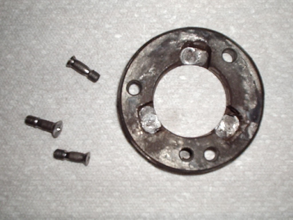

Good call Joe, when I got the cover off and moved the rotor I could see more movement than was ever meant to be in the starter clutch. The caps were completely gone and the rollers were making the chatter. I have another engine that I have been cannibalizing for parts so all I did was replace the entire rotor and it sounds great now. I have posted a picture of the plate to show the wear I found, notice the rounded out areas. Lucky no real damage was done.

WOW-That is bad.Good you have spare parts.I have a few myself.Joe
