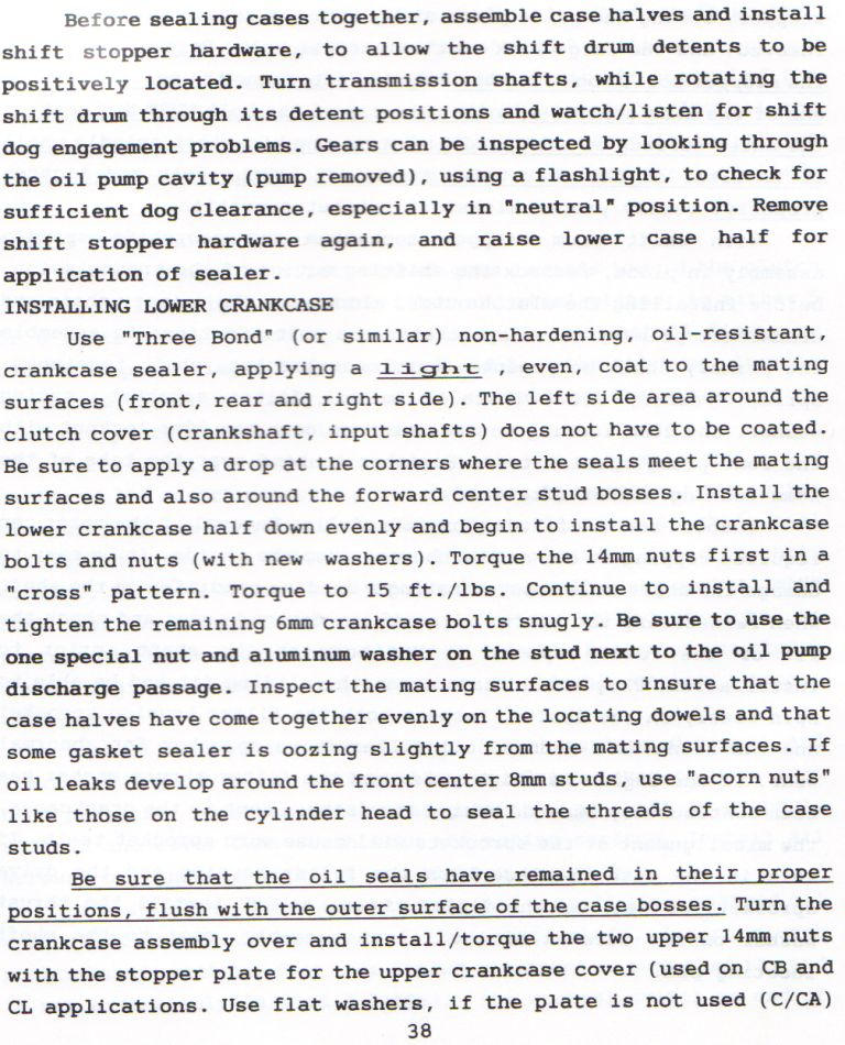

Hi, I can't find the case stud torque specs for a 305, anybody know where i can find them. thanks guys

Welcome to posting-on-the-forum! Pic below shows Bill Silver's torquing recommendations for the crankcase studs. My CB has 13mm muts but, as we all know, the Japanese sizing relationship between threads and metric 'AF' dimensions have altered over time. The 14mm nuts referred to are (obviously) the M8 studs.
I've used dowty washers (metalastic hydraulic sealing washers) on all the lower nuts and made those nuts plain, stainless (obtainable from most yacht chandleries); not a drip in sight -- well, from there, at least!
