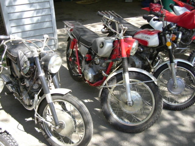

I ordered both books from Bill Silver. Here is a picture of the bike. The CB you see is a parts bike I got a while back.

that parts bike looks good enough to be a resto.
