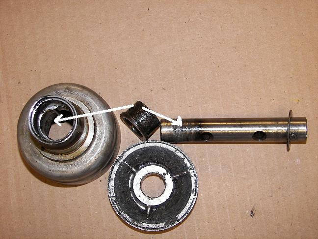

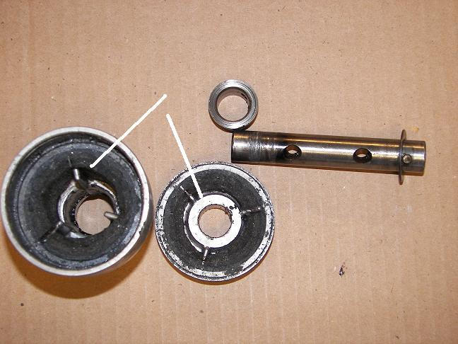

Post by LOUD MOUSE » Mon Feb 02, 2009 3:45 pm
Here are pics of what happens to the shaft and the engine end of the filter when it isn't cleaned and oil can't lubricate the shaft. See how full of debris the filter is!!!!!!!!!!!!!!!!!!. ..........lm
FILTER GOT HOT AND THE STEEL ON THE ENGINE END CAME OUT OF THE CASTING

Post by Gunner_CAF » Mon Feb 02, 2009 7:55 pm
Bad thing, Good pictures, thanks!

Post by Goodysnap » Mon Feb 02, 2009 8:13 pm
I dont know if that would be better or worse than what I found this weekend. When I pulled the filter out originally it was darn near spotless inside. I initailly thought this was a good sign until I found the Drive gear spinning freely on the crank and everthing that should have been in the filter was in the bottom of the crankcase. The nut was tight but the washer was not seated fully against the gear and the lock washer was broken. Been that way awhile I'm guessing.
