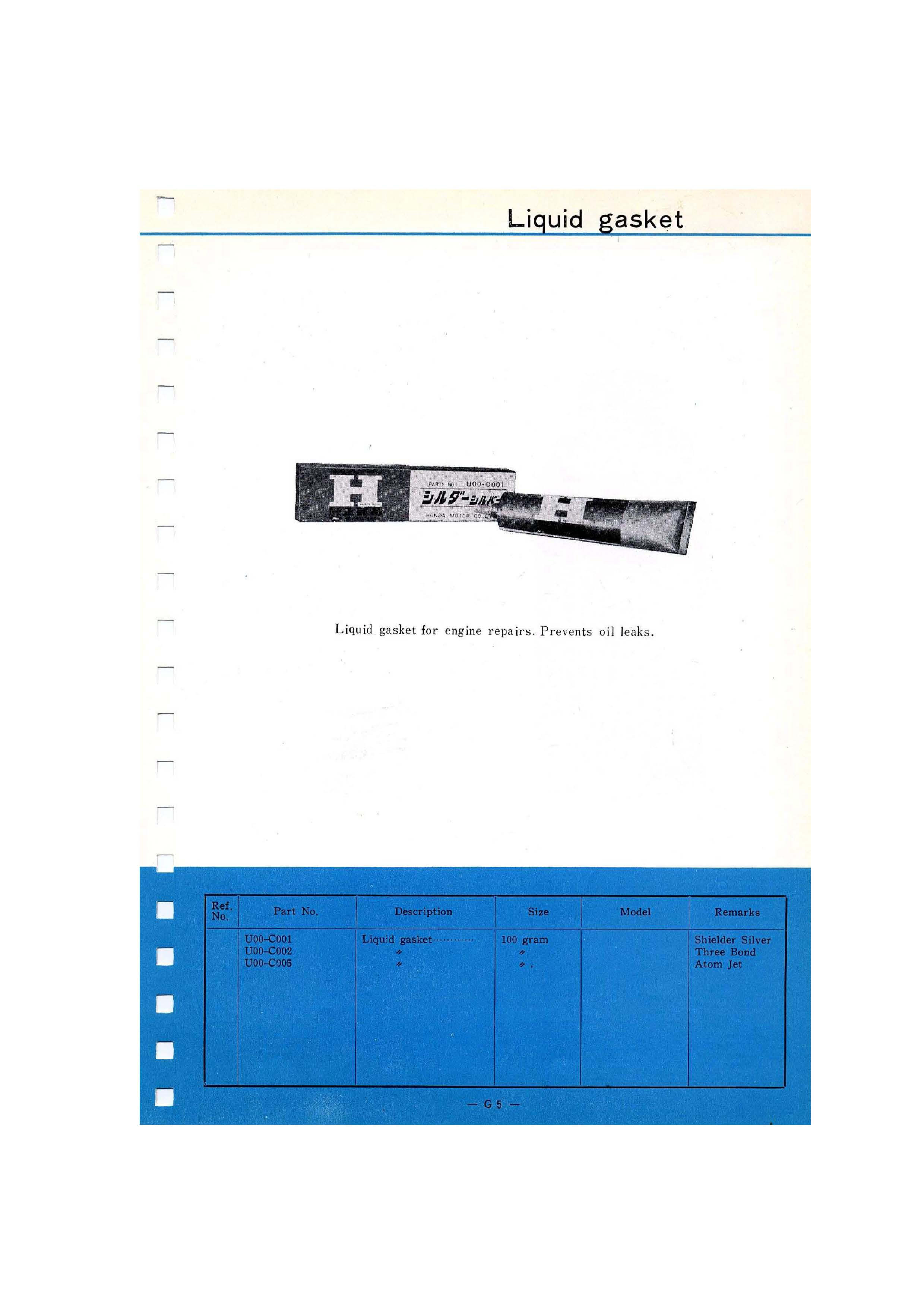

Post by kyle91987 » Thu Jun 10, 2010 8:54 am
Well, I have a bunch of Honda related PDF files and I found this in the 1964 accessory catalog.
Post by LOUD MOUSE » Thu Jun 10, 2010 9:07 am
Yep!
That was a long time back and has be issued with another produce name.
My local SUZUKI dealer looked up the HONDA BOND4 in a supplier book and got me a couple of tubes. ..........lm

Post by davomoto » Thu Jun 10, 2010 5:45 pm
If my memeory serves me correctly, Three Bond 1104 is the same stuff as well, and should be available at an auto parts store. I get the Hondabond from my Honda MC dealer. I actually have a tube of the origional Honda sealer, came in a lower gasket set from Honda.
