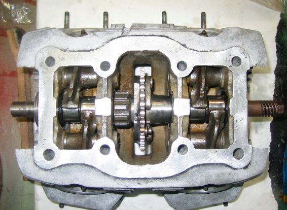

hey all, so, i just reassembled the top end of my cb77, i'm wondering how i can tell if the advance sprocket is centered with the crank shaft sprocket and will match up once the cam chain in installed.. ?
i'm guessing i'll put everything together for a dry test and see, then adjust accordingly but if their is a technique i would love to just get it right off the bat.

The end caps center the cam. ...........lm
						hillhudson wrote:hey all, so, i just reassembled the top end of my cb77, i'm wondering how i can tell if the advance sprocket is centered with the crank shaft sprocket and will match up once the cam chain in installed.. ?
thanx
Re: me too
As I said "The end caps center the cam."
HONDA didn't have time to custom fit each cam assy so that raised area bottoms to the outside bearing which centers the cams.
I've read the book and all that's fine but I've built apx. 50 heads and that's how I find/do them.
If ya don't have the cams bottomed to the sprocket and all bearings are not bottomed to the cams "even a thousand or two" and ya screw the end caps in ya will bind the cam assy and ya will feel the drag as ya turn the assy. ..................lm
quote="CL77NOW"]have all Bill Silvers books , parts lists. op guide, and others but .... .
CAM SHAFT END PLAY:
page 46 says "just short of touching" with end caps mounted, sans gasket. ok
i can slide cams either way with both spline locks loose.
my guess get cams 1 to 5 thou from caps,?
my guess, is to tap both cams against caps
and then lock both splines clamps down
then the gaskets thickness , becomes the end play.?
anybody have a more sure way. or a spec, gap, so i can cut shim stock and set it that way?
thanks for any help

will get my 305 guy to help me. this is not clear to any mechs in our shop, some with 45year exper.
