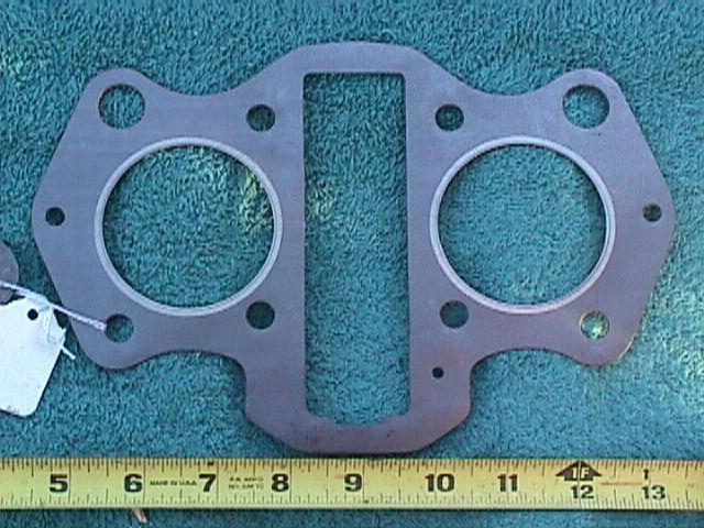

#1 Is my head gasket weeps ( its the blue one)
i have got an original (honda) but there is an extra hole iin it...can i use it?

The Honda head gasket is fine if we're talking about a single, small hole punched at the factory (at about 10 inches low in the picture). Either the older or newer version had those - can't remember which.
-48
-48
thanks 48 lesco! thats the hole for sure. one problem down.
