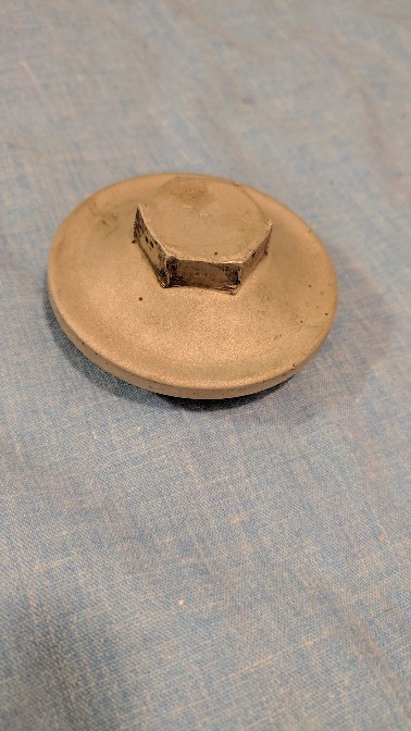

Are these the right tappet covers 66 cl77
Post by barnbiketom » Thu Mar 02, 2017 9:23 pm
While looking for better condition ones, none look like these. They work, fit good and all 4 the same. The ones on eBay etc have "humps."

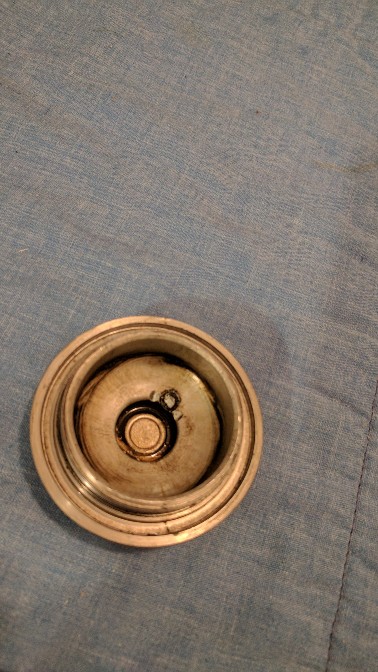

@##!??## dammit I guess by the looks inside of them I'm screwed haaa..
Answered my own question!! They fit but CLASH...I wonder how long this thing has been this way?????
Well I'm looking for 4 tappet covers now..

Honda used 4 designs of these.
That is from adjusting the tappet when the engine is 180 degrees off. ............lm

Got it LM.
Thanks a million
Maybe this thing will run huh haaaaaa
