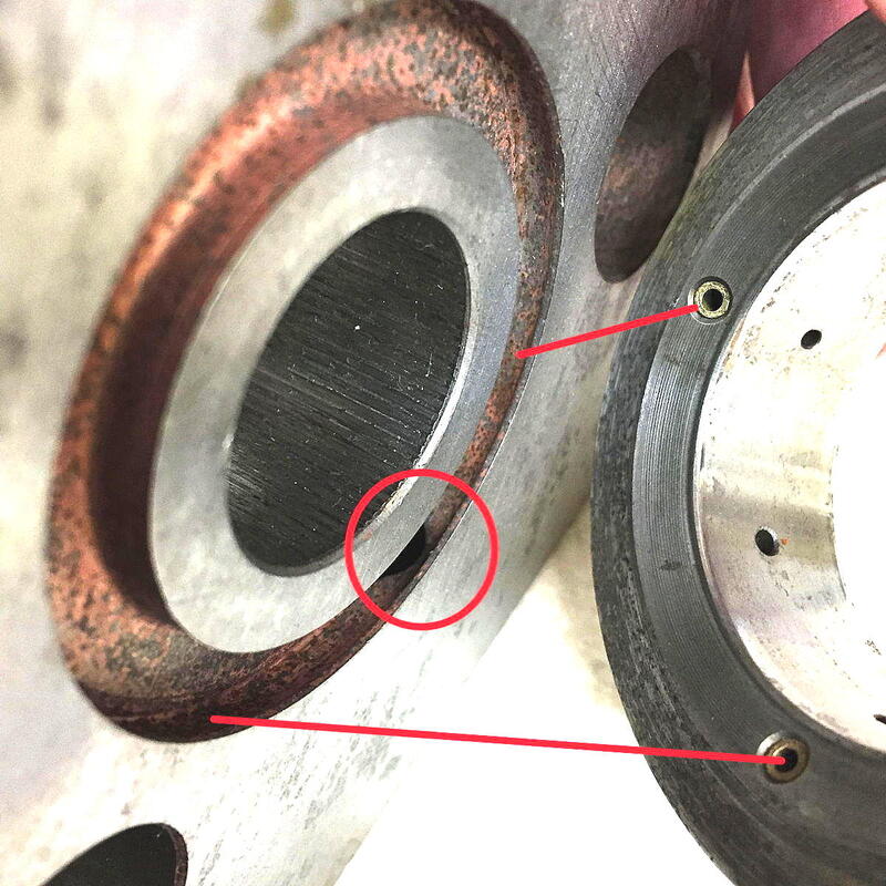

Did you check for dirt/sludge in the centrifuges and big-end pin?
I strip the crank completely and clean everything before reassembly.

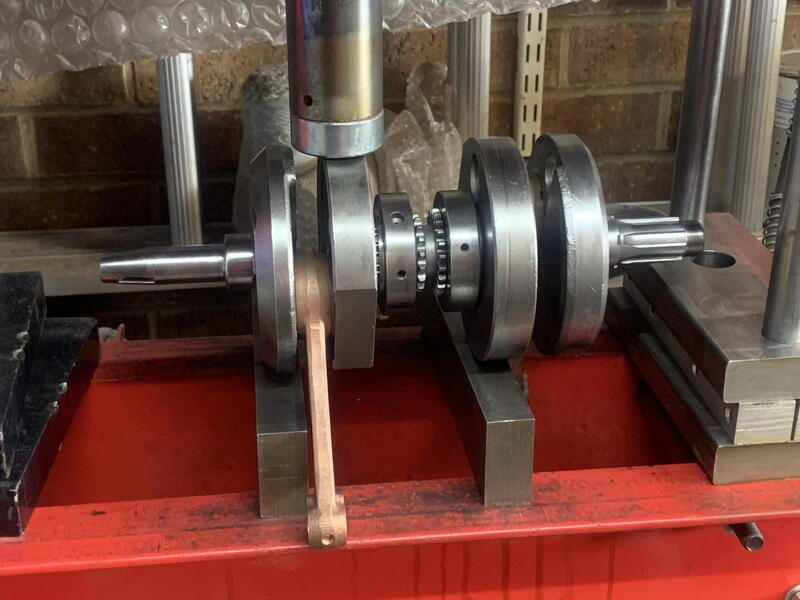

Like you, I true up in the crankcase but use my press rather than a mallet.

Never thought of using the press to align the wheels, that's brilliant.
