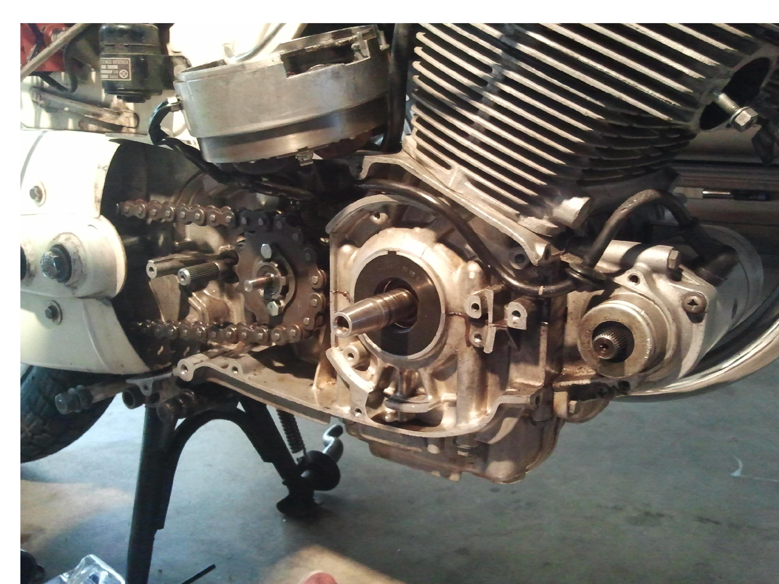

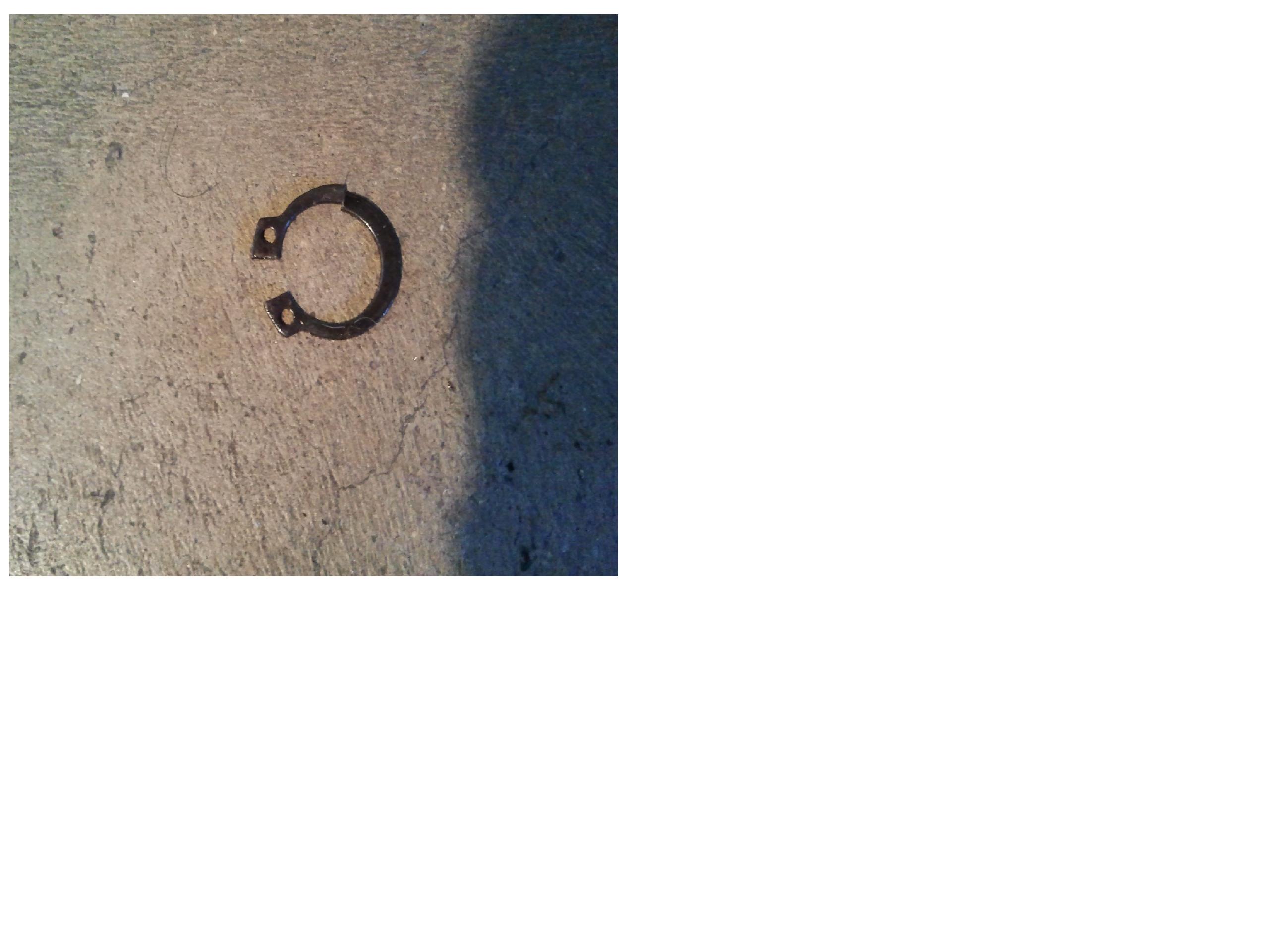

What size is the circlip and or where can i find one??
Number 14
Number 14

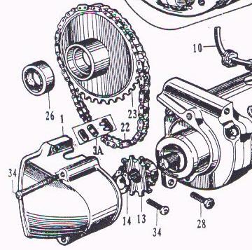

Post by 48lesco » Mon Oct 03, 2011 8:16 am
13mm supercedes to 94510-13000. Retails for 62 cents at your Honda dealer.

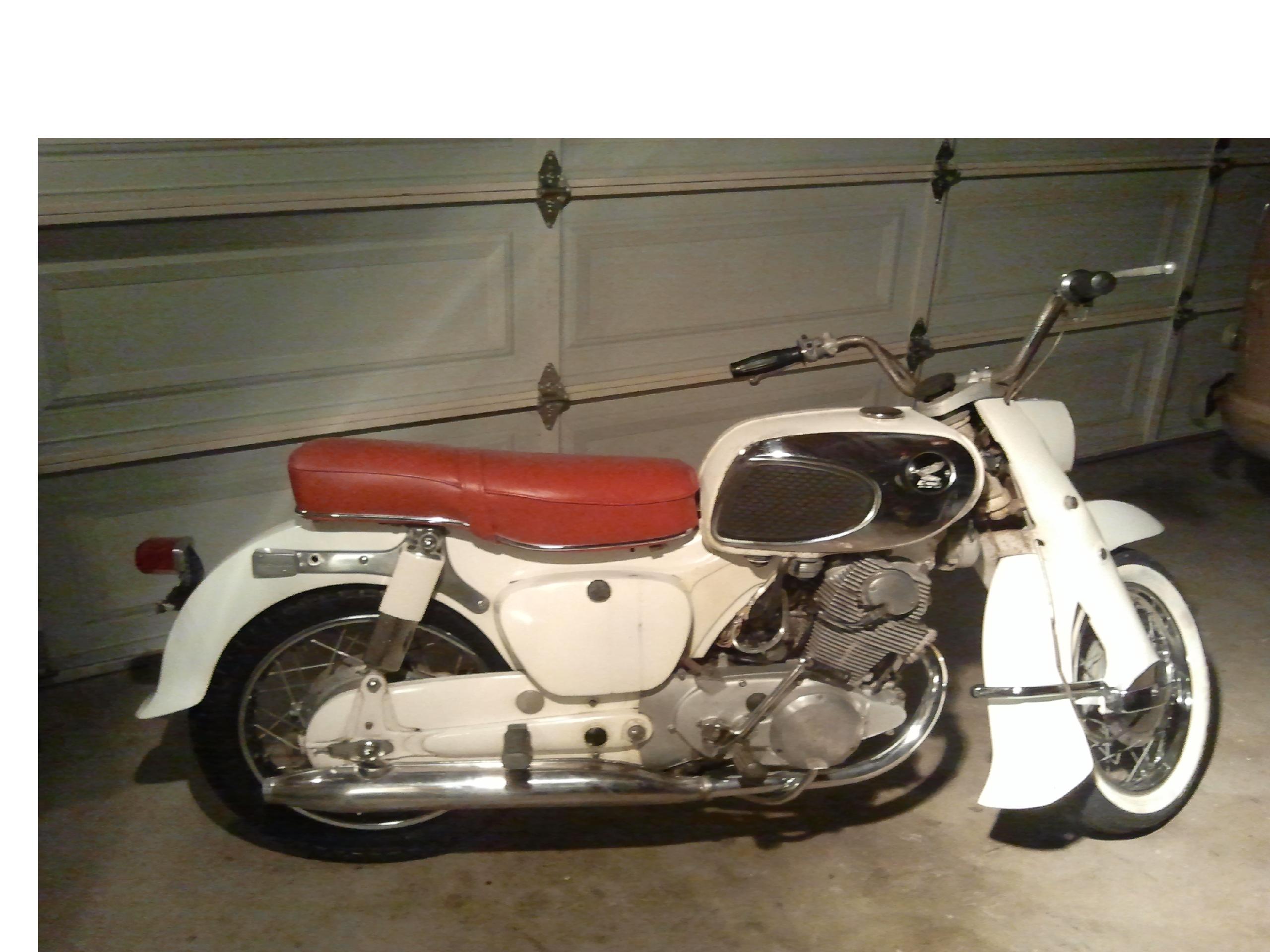

You would be surprised what you can still get brand new from Honda. Mostly hardware, gaskets, seals, etc. There are even folks out there who sell these "vintage" "NOS" parts on ebay for 5x retail. Do your homework - always check with Honda first. BTW - That is one great looking early Dream!

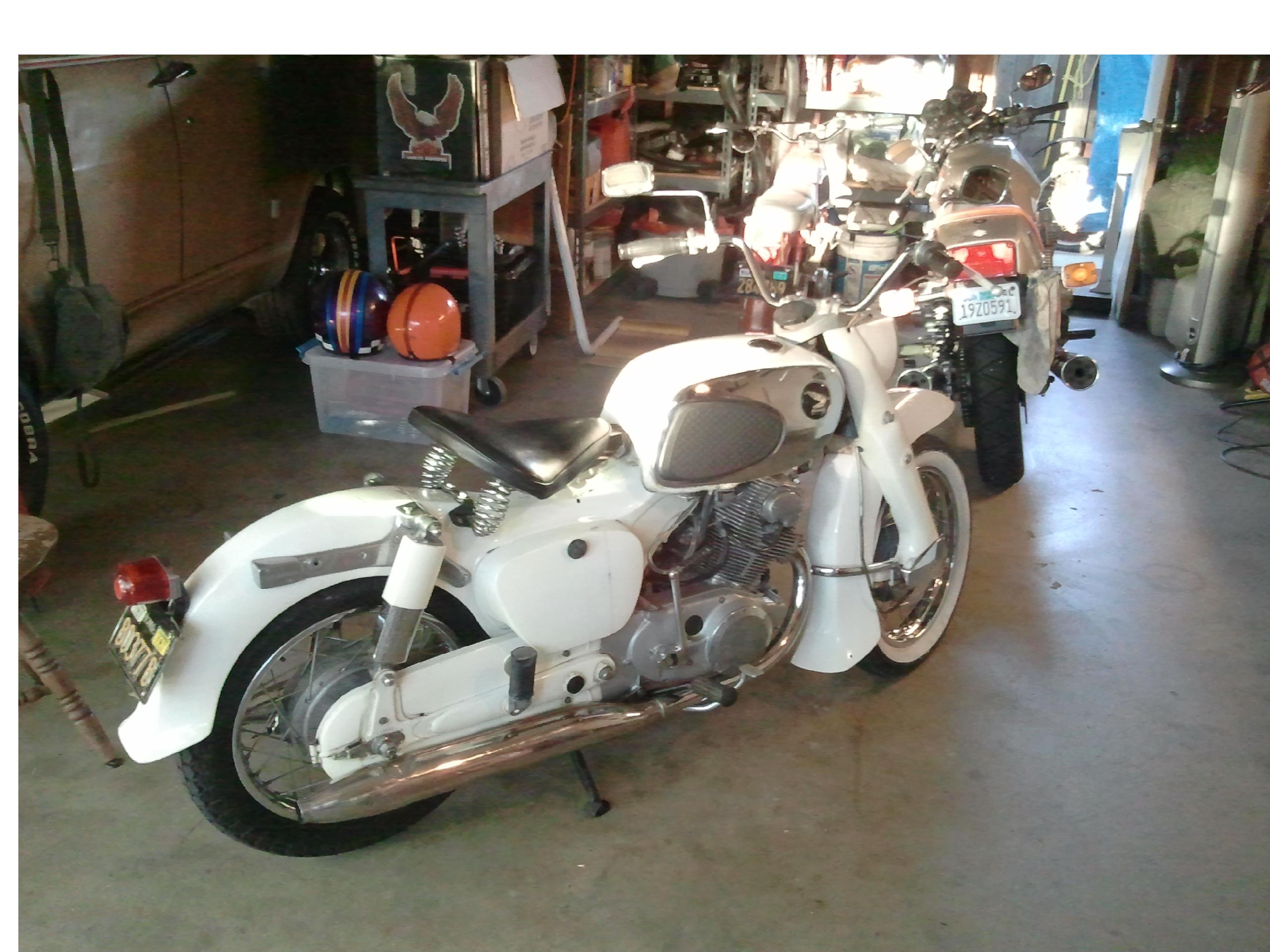

Lesco, I have tried all local dealers in my area no luck with that 13 mm circlip, I had to use a inside circlip which does not sit right, put holds it in place for now.

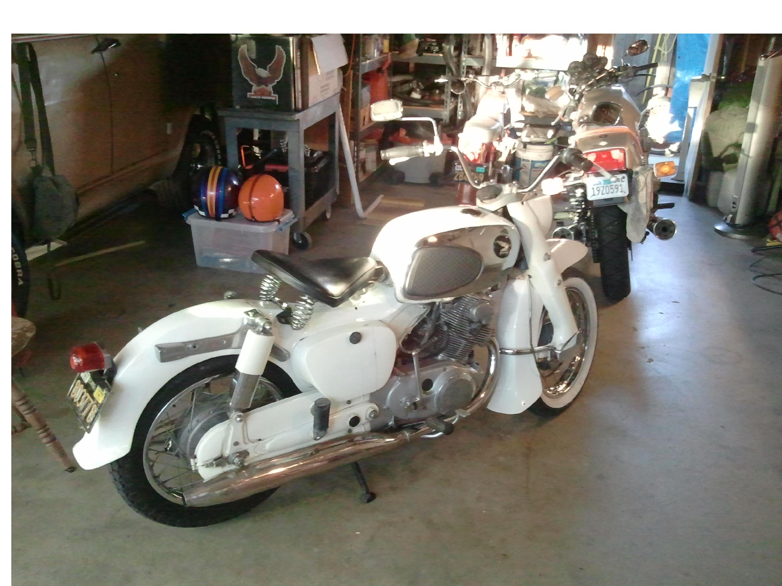

Thanks to the forum It has made it easy to work on my 65 Honda CA77, I have replaced all the seals on the kick starter side, It no longer as any oil leaks, Also learned these Dreams have sticky clutch plates, when engine is cold or been sitting for a very long time. So my next step is to replace or clean the clutch plates. Mean while I would be riding it before the winter begins. Also in need for two white walls if anyone has or know where to find, attach our a few photos of the 65 Honda Dream CA77 305….lol lol.
