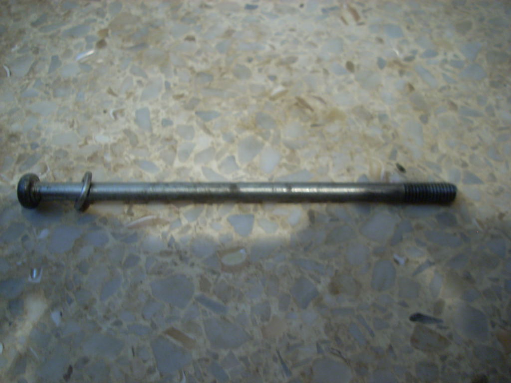

Thanks all for the help and info. I searched around the web and found an OEM replacement bolt on ebay and it was $30 plus $18 for shipping!! I searched outside of ebay and found some aftermarket ones for around $4 with $10 shipping. But I noticed that the bolt didn't look like the bolt that came off my bike. I got the part # from the parts book, but mine is a long phillips head screw and the one from the parts book looks like a bolt with a nut on the end. I don't know if a previous owner replaced it with this screw or maybe the 1962 model used this bolt instead of the other bolt? I'm not sure what to order now. I checked out McMasters and they seem to have a zillion bolts on there and I'm not sure what the thread measurements are for this bolt. Below is a pic of the bolt that was on the bike and a pic of the replacement part bolt. Any help would be appreciated!
original bolt
original bolt
replacement bolt
replacement bolt
