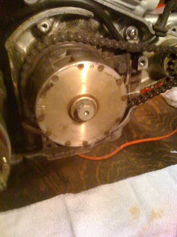

I've got starter troubles. I guess the starter clutch rollers have gave out. So, I need to pull the generator. I've tried leaving the chain on, putting it in gear, and trying to loosen the bolt. Is it standard thread, (not backwards, bastard thread?). Would an impact air wrench be better? So far, hasn't come loose.

P.S. I've gotten a 16mmX1.5mm thread bolt already to pull the rotor off, as per threads on here.

It has a stander thread.
Ya may be able the put a 14mm box wrench on the bolt and SMACK it with a mallet to get the bolt loose. ............lm
