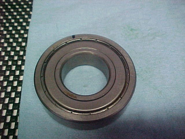

Post by davomoto » Sat May 26, 2012 11:40 am
Back to working on this motor. I got the ball bearing, andf it has a metal shield on one side that faces the crank when installed. Is this correct, or should the shield be removed?
Thanks, Davo
