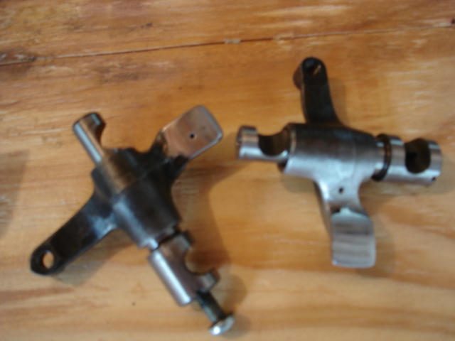

Ok So I did not pay attention to the rocker arms when I disassembled the head from my scrambler. I did look at a parts break down before hand and noticed the rocker shafts are different but the Rockers themselves have the same part number. I have 2 different rocker arms. One has the oil hole in the pad that rides on the cam lobe. THe other has the oil hole between the shaft and the pad. My guess is the one with the hole in the pad would go on the exhaust side the other rocker would get oil to the lobe because of the rotation. Tell me if I am wrong (quite often I am). More info may be on my Bill Silver cd however it is at my office some 30 miles away and I would like to get the head done today. Any help would be appreciated

It does not matter. The one with the hole on the pad is just the later version.
