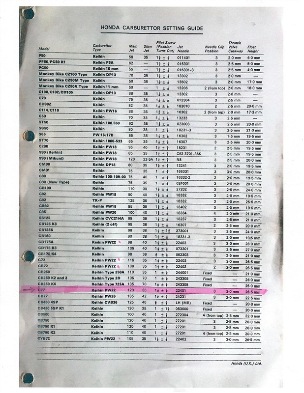

Here are my carb setting and what I've done:
- 130 main jet and 40 slow jet;
Jet needle on 4th ring down / or second from bottom
Checked that throttle slide would fully seat with throttle screw out and throttle cable loosely adjusted
Float adjusted to recommended height
Air screw loosely tightened and backed off 1.5 turns
Throttle screw lightly seated
