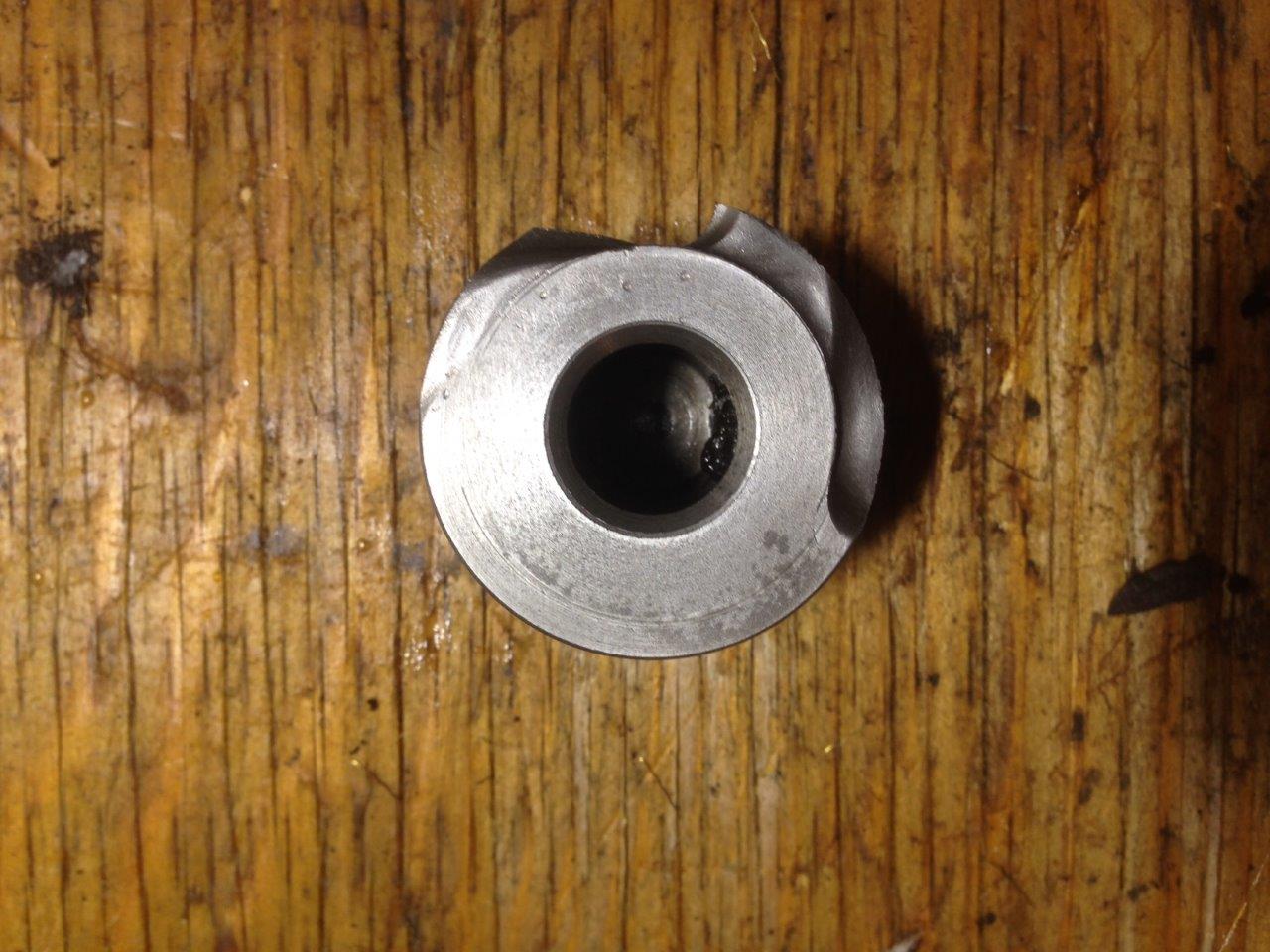

One thing I should of noted is the kickstart prawl is not in the transmission right now. I did have the kickstart prawl in the transmission, but when this issue came up I have been taking it apart and reassembling it to try and figure out why it is not turning smoothly and have not been putting the kickstart prawl in. Unfortunately that noise in the video is not the kickstart prawl, its just the transmissions gears.
G-Man, when I get home I will check the selector fork, I did replace one selector fork because one was visible beaten up. I'll rotate the selector fork to different gears to see if the problem exists in every gear.
DianneB, how can I tell if the shaft is in the wrong position, look for a damaged part? The transmission was really beaten up, I've had to replace the bushing on the end of the kickstart prawl that looks like a top hat (see attached picture), the kickstart spindle, the 14mm brass bushing, one of the fork selectors, the top gear and I eventually found the kickstart prawl and spring by the oil trap.
