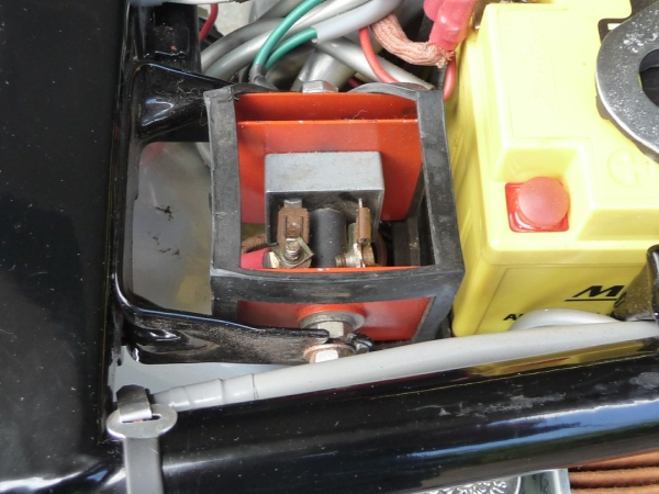

Post by DJM » Tue Mar 28, 2017 2:00 pm
Or you can 'hide' it inside the old metal plate rectifier like this.
Mine's been like that for a couple of years and works fine.
