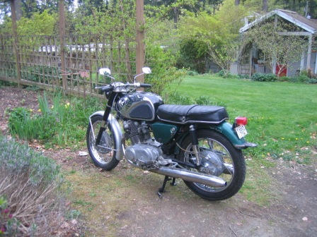

Not much change from the photos of when I got it in December.  Front fender is on, mud flap is attached, has mirrors now.  New paint and all that will have to wait.  The local Harley guys tremble when I drive by.
