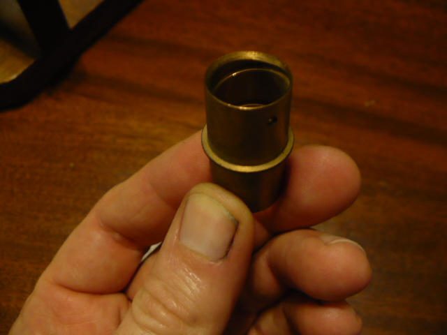

It looks like your 14mm bushing is shot. I am attaching a photo of what a new one looks like. That ridge on mine measures 19.92mm diam. It looks like yours is worn to a nubbin. I believe that ridge acts like a thrust washer and keeps the counter shaft from touching the low gear.
HT

Post by sarals » Tue Jul 31, 2012 11:55 pm
You're right, mine is toast! The ridge is much smaller than that, clearly worn. It looks like the transmission I bought last month will go in the engine after all.

Post by jensey » Wed Aug 01, 2012 2:26 am
Hi,
Not everything what shines is good. Kickstarter pawl ?, I would replace it without hesitations.
14 mm bushing ?, just like Tom said, it's shot. Did you draw your conclusions on your transmission with the eye or with a pair of callipers ?
When someone is for the first time in an engine one can be overwhelmed with joy and happiness, because everything seems to be in nice shape, and draw the conclusion that it is ok. But everything runs in oil, so it is clean and as long you don't see heavy damage, it doesn't mean it's ok.
