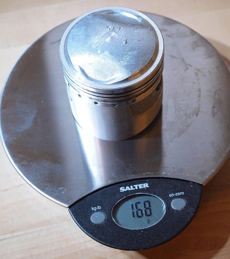

On your pic CB rebuild 039 it looks like the top ring has a piece missing. That probably indicates a worn bore.
Jensen is right. Measuring things is the best way to understand what is wrong. Buy a digital caliper and get some measurements. Clean all of that oily black crud off the top of the piston and you will see markings which tell you what size they are. The one in my pic is 0.75mm oversize...
You have done the difficult bit in taking the thing apart. All that is required now is the interesting bit. Clean and check the condition of the parts, work out what to replace by measurement. Reassemble with care and all of your new-found knowledge. You do not need to rush.
Understanding what is worn / broken and why can save you a ton of money. There is plenty of free advice here and numerous books you can read.

THe gap just looks too big to me. Does it close up if you squeeze it back into the groove?
It's still a good plan to clean off the top of the piston as this (along with the condition of the bore) will tell you what is the next size you need to go to.
You don't need to buy a bore gauge. One of these is a very useful tool for many jobs in the workshop, it will save its cost many times over.

You can use feeler gauges to check the clearance from piston to bore.

Thanks, I started cleaning, and no marks on the top of the pistons.
I have a digital caliper, but that will only tell me the measurements at the top and bottom, and won't tell me out of round, will it?

What does it look like if you slacken the adjuster on that valve? If you have been running them tight the valve seat may be burnt. Not sure that would produce the smoke you mentioned earlier.
There's so much oily carbon on your pistons that the bike has been clearly burning oil.
What do the bores look like? Any scoring?
Why are you worried about out of roundness? Pistons are never round.

I was thinking out of round as to the cylinder, not the pistons - sorry.
I don't see deep scoring, but then again I have no idea what I am looking at!
