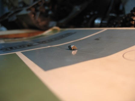

I found this piece of shrapnel in bottom half of the case.  It is clearly a piece of a gear tooth.  However, I have looked at the gears closely and can't see a chunk missing on any of them.  I'll look harder.  Perhaps it's from a gear somewhere else (?)

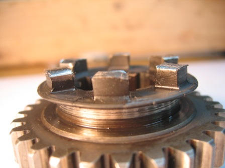

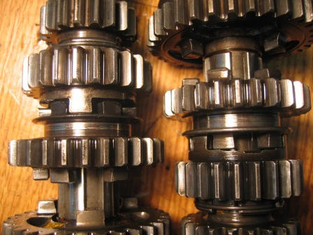

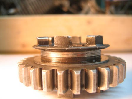

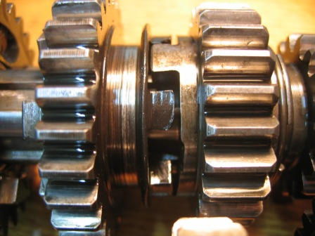

You can see here what the problem is...the gear on the mainshaft in which the shift fork rides has been actually worn thin by the fork straining to shove the gear toward the center.  The dogs are likewise quite rounded.
You can see the difference between the gear that's been having the problem and its counterpart gear on the lay shaft.

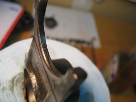

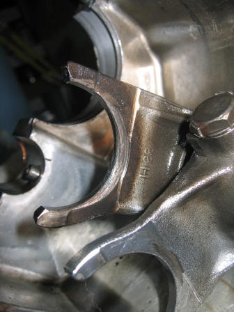

Here's the shift fork to the mainshaft...it's very worn on the rubbing surface toward the center of the motor and actually looks burned.  Must have been quite a lot of friction.  Also the fork ends are quite worn.

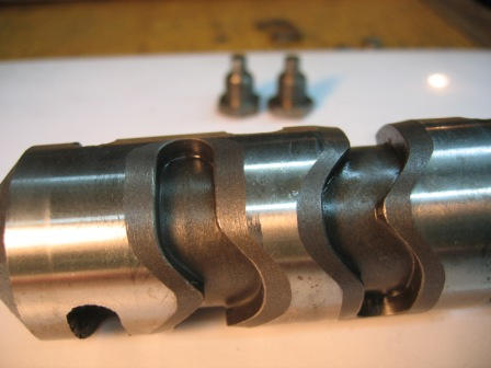

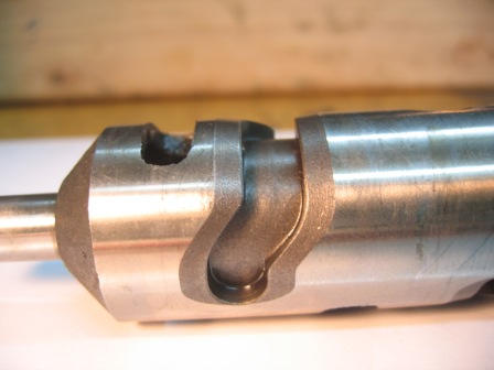

From the looks of the fork and slider I recommend ya take a really good look (send pics) of the shift drum at the high points and the rollers. ..............lm

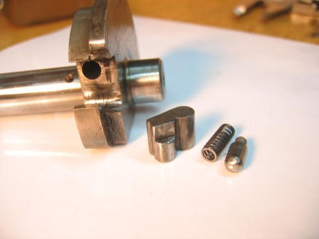

I make sure all dogs are flat and sharp edges and I make sure the brass bushing in the output shaft isn't warn into the center of the hole.
I also look at the 14mm brass bushing and KS pawl plus the area of the KS shaft where the 1/4 in. bearing are located.
Show pics of all these?. ..................lm

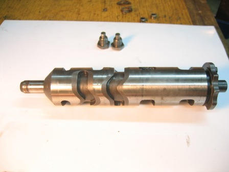

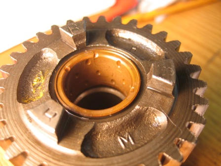

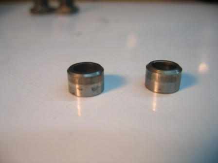

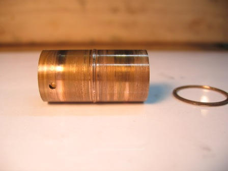

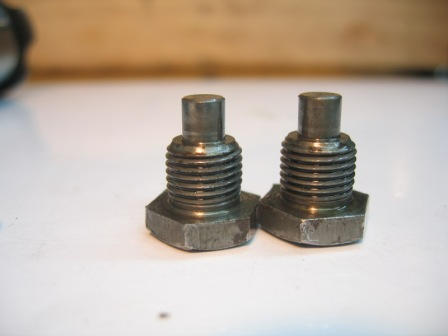

I removed the shift drum and forks and took some photos. Also some pics of the brass bushing and the output shaft bushing and kick pawl. I don't see anything that looks slightly worn except that sliding gear and one fork. I'm welcoming comments on the photos:

More photos:

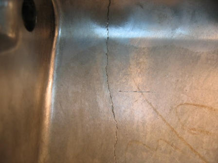

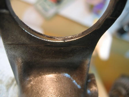

Here's something interesting:  below the shift drum one can see a pretty long crack in the case.  Surprisingly it hasn't migrated visibly to the outer surface.  Has anyone else experienced such a thing?  I'm wondering how common it is.  The engine being a
