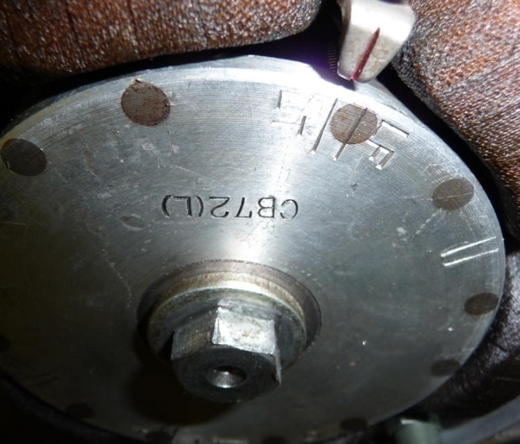

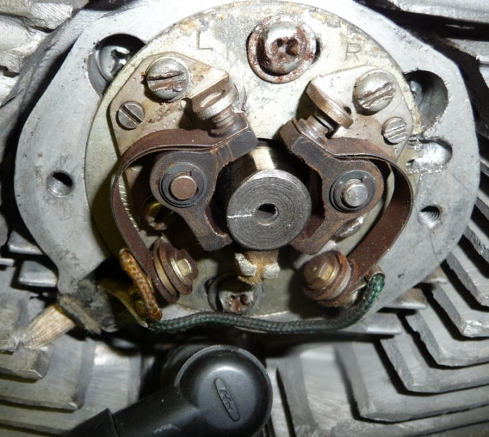

Thanks for the tips! After talking to Ed today on the phone, I realized my problem was that I tried to treat the Superhawk Motor like one of my BMW Twins. BMW Twins have a 360 degree crank and use a wasted spark. So when you need to adjust the valves you set the engine at TDC, and spin the pushrods on the engine and one side will be ready to adjust, then you spin the motor another 360 degrees and adjust the other side.
Now the Superhawk has a 180 Degree crank, which completely threw me off, plus I tried to adjust the valves like it was a BMW twin, which we know it isn't even close!
So what I found was the easiest way is to take off the rotor and the points covers. Set the rotor to the "T" mark, so that it looks like the first picture. Is the mark on your cam pointing straight down? If so, then you are ready to adjust the RIGHT SIDE valves. If the mark is at the top, you need to rotate the engine another 360 degrees so that the mark on the cam is pointing down, like in the second picture.
Set both valves to 0.004" or 0.10 mm.

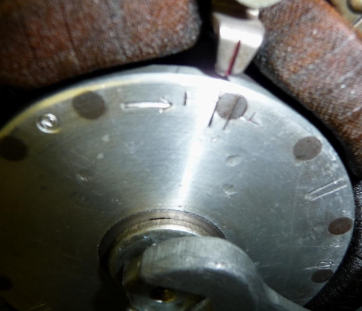

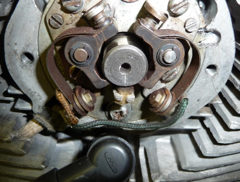

Now rotate the engine 180 degrees and set the rotor to the "LT" mark, as in the 3rd picture. The mark on the cam should be pointing to the left, 90 degrees from where it was. This is because the cam spins at half of the speed of the crank, or in other words it takes two full revolutions of the crank for the cam to spin one revolution.
When the motor is set up as in the 3rd and 4th pictures, then it is ready to adjust the LEFT SIDE valves. Also set them to 0.004" or 0.10 mm.
You will need to spin the motor another 540 degrees to get back to the point where you can check the right side valves, which I suggest doing.
Sorry if this is stuff that most people on this board knows already. It has been an interesting day of trying to figure out what the hell is going on with this adjustment process! Thanks to Ed for talking me through it. Now onto the points!! :-)
