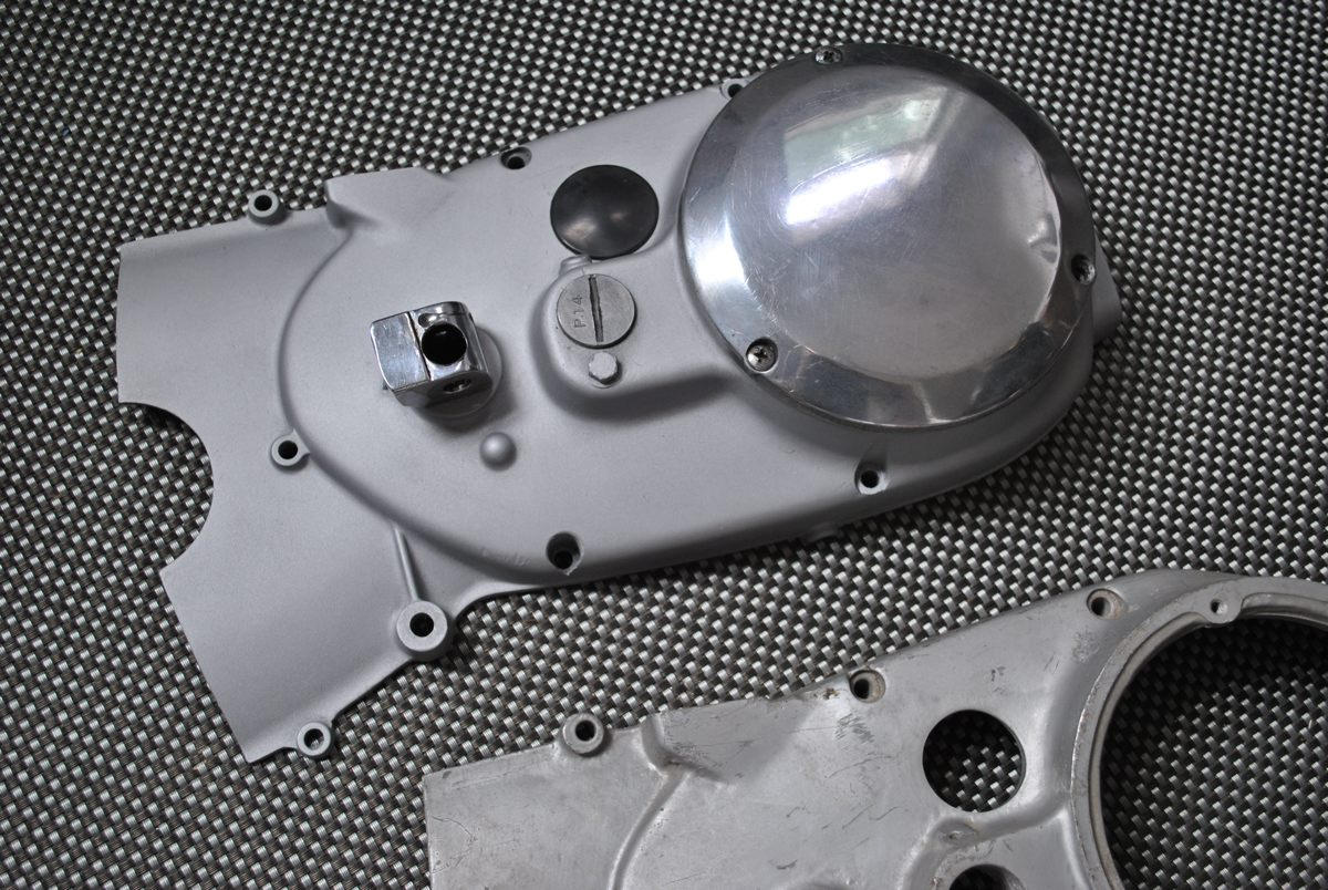

I've tried a lot of different paints to match the OEM dull aluminum color.  Best I've found in terms of color, simplicity, and fuel resistance is by far:
VHT SP127 Universal Aluminum
I usually paint after wet sanding aluminum to 320. Spray on 4-5 light coats about 15 min apart. No primer required. Let it sit overnight, then bake it at 200F for an hour. I used the kitchen oven when nobody was looking, and there was no smell.

that looks really nice. i powdercoated my engine a standard silver with gloss killer added to the powdercoat to give the silver a dull look when i split the cases. turned out very nice.48lesco wrote:I've tried a lot of different paints to match the OEM dull aluminum color. Best I've found in terms of color, simplicity, and fuel resistance is by far:
