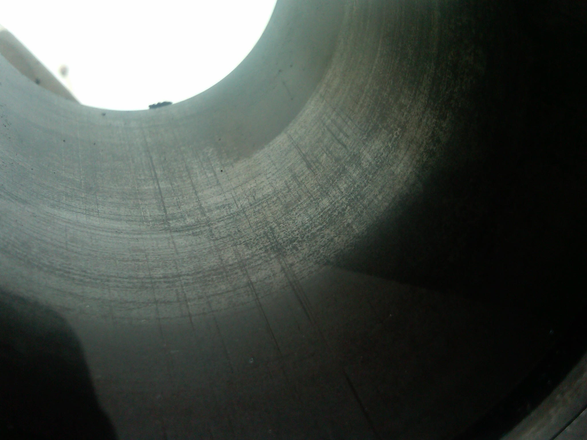

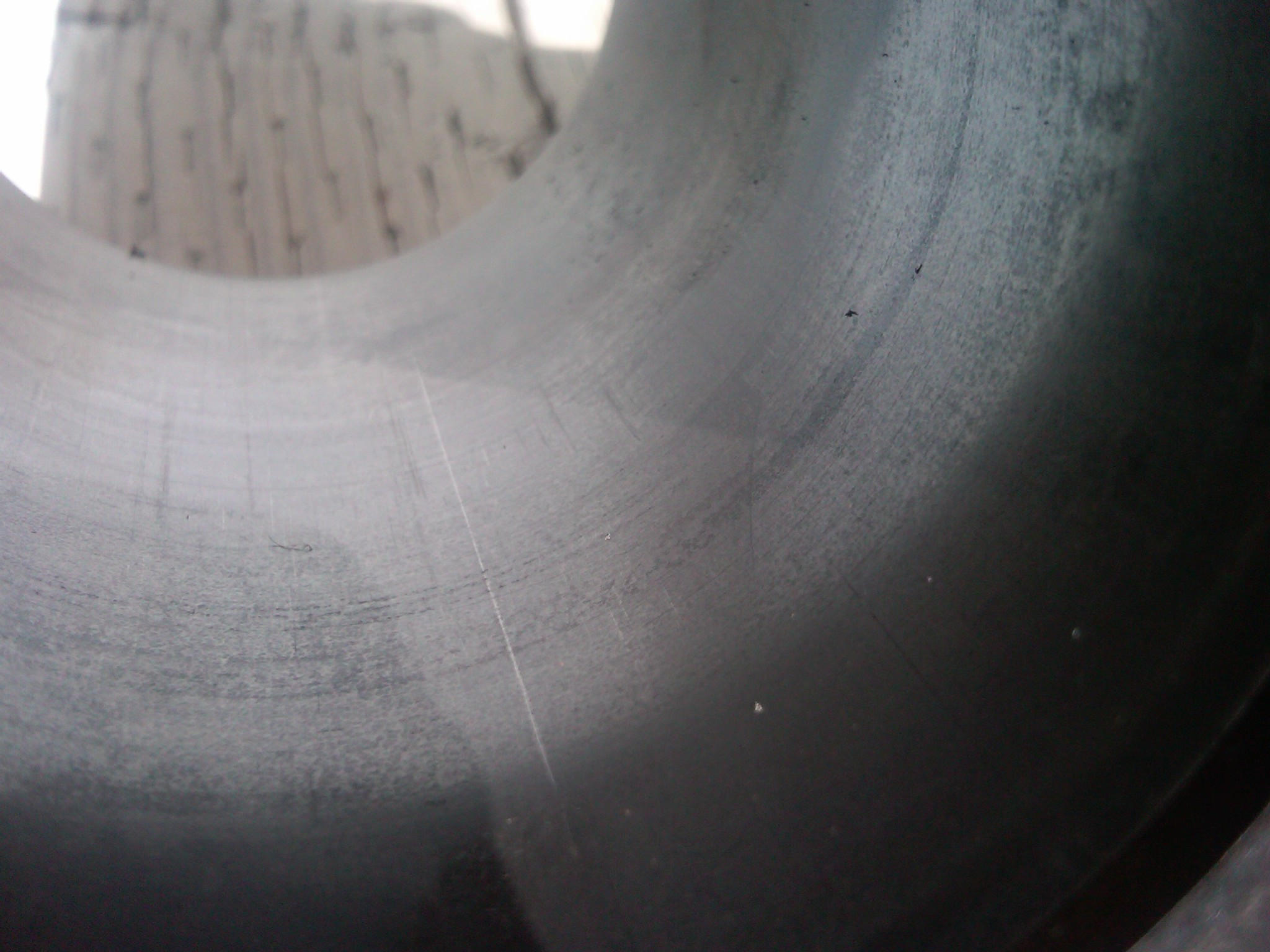

The bores have quite a few scores in them. My inside michrometer doesn't go small enough, but I have no doubt there's plenty of wear there too. I think the only question now is which oversize I'll need for it to clean up. I'm not overly disappointed, since this all gives me a good excuse to put in the right pistons.

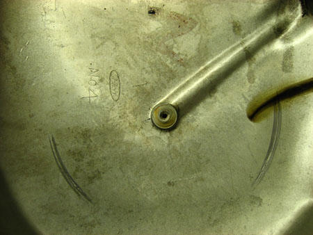

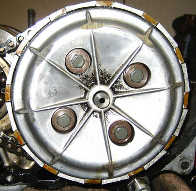

Light groove in left cover where it appears clutch had rubbed. I'm not sure what's going on there. The clutch cover has been ground off at the outer circumference at each rib.

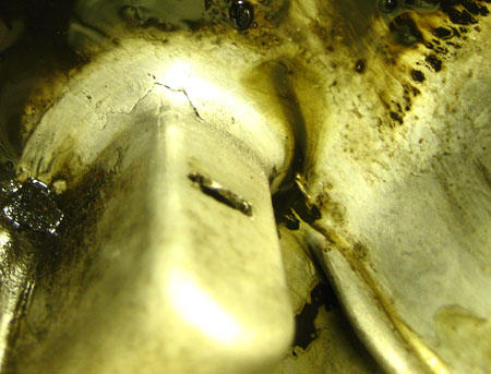

The biggest concern- crack in the upper case. I had suspected there might be one. I previously posted a picture where at some time the drive chain had piled up into the case. The left side of the chain caused a crack on the inside. The debate is whether to have it (and the crack in the lower case, in a non-critical area) welded or patch with JB Weld.

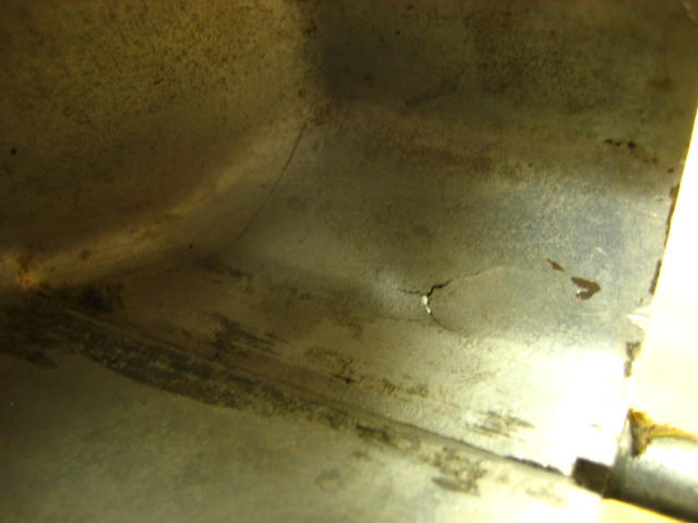

A possible crack inside the case on the left side under the rear shaft. I don't think it's a problem, but I've been wrong once or twice. Okay, according to my wife, many times.

I've come up with the dowels that were missing, torn everything (engine wise) down, cleaned and inspected. I repaired the damage to the cases caused by the drive chain with JB Weld. the inside are I roughed up the cracks (which didn't appear to go through) and sealed with JB Weld.

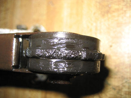

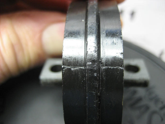

I lapped the valves, checked with solvent and they seal well. Cam's and lifters look good. The spocket on the cam was slightly loose on the center. I wire welded it carefully, being certain not to get it too hot. One problem I did notice on disassembling the head is that the lefthanded nut on the center assembly was loose. The cam adjuster wheel was shot and may have been a related problem. There is also a small amount of wear on both sides of the center rib on the large idler wheel. There is a line on the wheel that goes across it (see attached picture.) Is this normal? It doesn't appear to be damage.

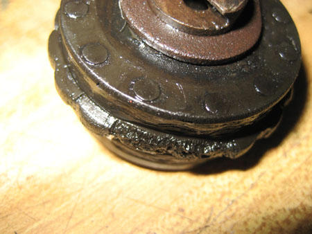

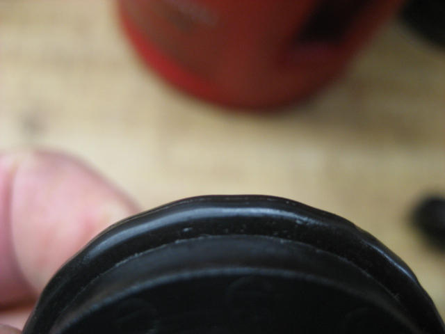

The adjuster I got off Ebay is starting to sprocket. From looking at the parts I finally figured out this is the beginning of the problem the original wheel had. I guess I'll try LM dressing method, hopefully I won't have to take too much off to clean it up.

along the lines of your tensioner wheel, I've noticed that the two parts engines I took apart have horrible tensioner wheels. Broken apart and very "sprocketed" as you put it. Would it make sense replacing the wheel with an actual small sprocket? I figure that would be the ideal solution. Anybody have any input on this?
