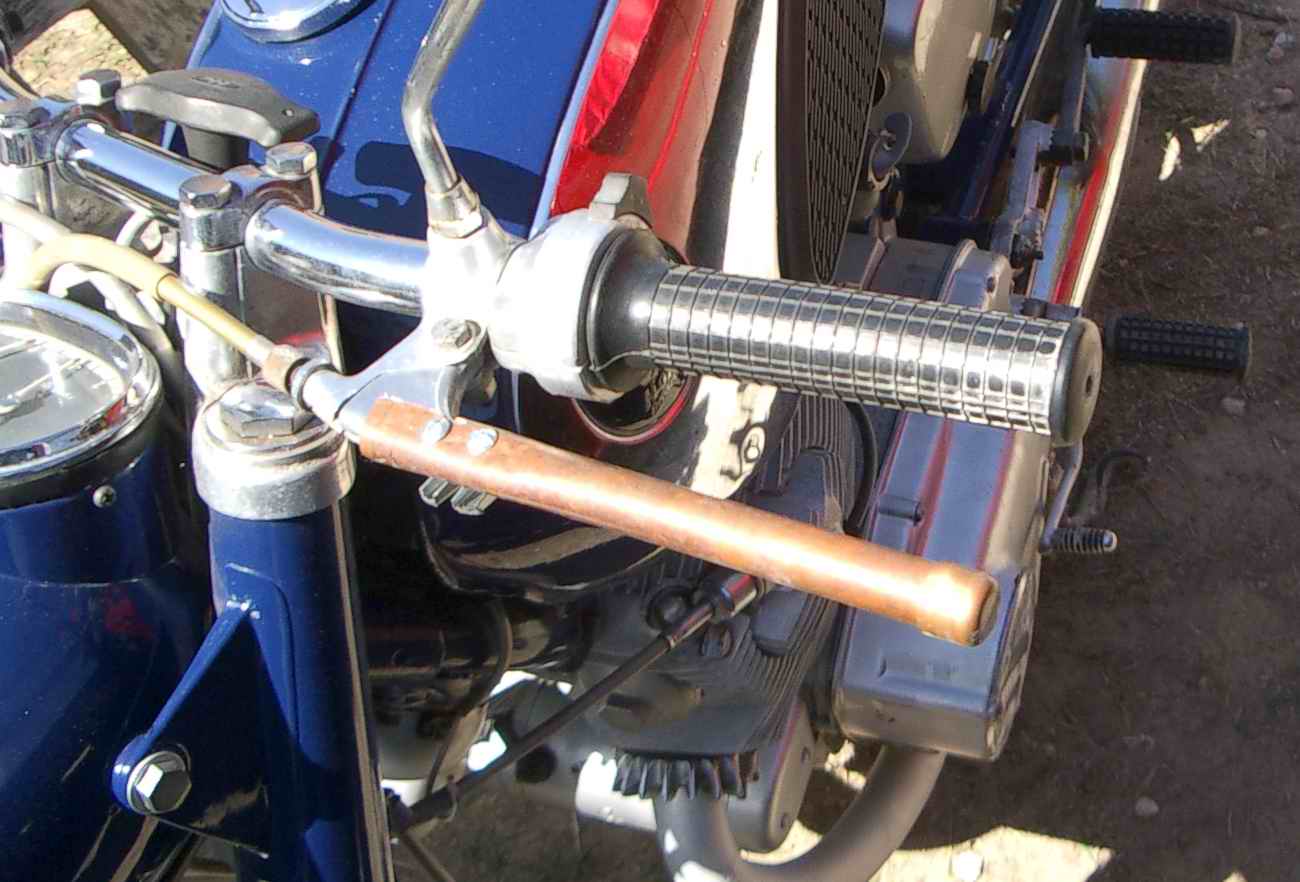

Never broke a cable, but I did break my clutch lever back in October, about 80 miles from home pulling into a friend's driveway.
Embarrasing story, let's just say i re-learned something I already knew: don't use the front brake with the front wheel turned, even a little, especially in a soft caliche dust driveway.
Thought about Spargett's trick of turning brake lever over and using that, but then I'd have had to ride home with no front brake. Scrounged in Charlie's junk/stuff and came up with a piece of copper pipe the right size and fixed it enough to get me home.
Only right sized fasteners we could find were toggle bolts, so we cut off the ears.
