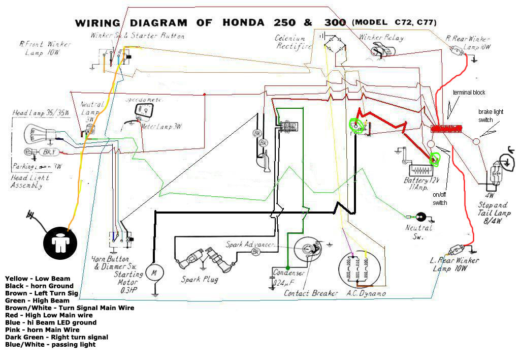

Ive also listed my controls and the line colours for them below... Sounds like the switch is the grounding point, so I would need to run the reds (+) instead to the lights, becuase the switch is a grounding point when activated, not the other way around... The way we have it looks like the switch is a power (red +) point... get me?
See below diagram adjusted...

Post by brewsky » Thu Dec 02, 2010 5:22 pm
Sascha wrote:e3 - Yep, good eye/guess!
Brewsky, on the Starter Magnetic SW why does your diagram have it bypassing the ON/OFF switch?
There are 2 reds running to it, one direct from the battery, the other running after the on/off switch... is this correct? I have highlighted by bypassing of the on/off switch with neon green circles.
-Sascha
It is correct as the large (thick) wire carries too much current to go thru the on/off switch.
The solenoid is actually a remote controlled switch that causes the two large (thick) wires to connect to each other to provide power to the starter motor. The small red wire (red/black on the original wiring diagram) carries the smaller amount of current to the solenoid to engage it when it is grounded by the starter switch on the handlebar (or in your case the arcade switch).
Post by brewsky » Thu Dec 02, 2010 5:32 pm
Sascha wrote:Ive also listed my controls and the line colours for them below... Sounds like the switch is the grounding point, so I would need to run the reds (+) instead to the lights, becuase the switch is a grounding point when activated, not the other way around... The way we have it looks like the switch is a power (red +) point... get me?
sascha
Not sure I follow you..
Some switches are grounding....ie the starter switch, neutral switch, horn switch
Some are not....ie.... headlight dimmer, winker, brake light switch
You need to undo the 2 red wire additions to the last drawing (at the winker lights), as the power is getting to them already from the winker switch, which gets it from the winker relay

Sasch: Your reinventing the wheel here; It would have been a whole lot easier to relocate the original switch where ever your new power switch is and rewired it with the same color code on the wires then added new wires to your arcade button to be in series with the switch (both would have to be on) you wouldn't have to be replacing the whole harness.

Sascha wrote:Hey guys so last night I tried to wire up the existing harness and failed... There are some fundimental issues that I cannot resolve with the new setup so I have to create an entirely new harness to support the changes in electricals.
I will start drafting a schematic to show you guys what I am considering doing and post it here to get your inputs.

Sometimes a man needs to brake something beautiful... The existing wiring harness was great, but with my build, i may as well go that last mile and make an new harness that im familiar with.

Post by brewsky » Fri Dec 03, 2010 12:51 pm
Sascha,
Are you planning on a new rectifier?
If not you may want to reconsider as they can go bad with age.
See this thread for my personal experience:
http://www.honda305.com/forums/viewtopi ... ight=smoke
I ended up using one of these and it has worked well:
http://www.radioshack.com/product/index ... Id=2062584
You can also get OEM style modern replacement rectifiers from Ohio Cycle or Retrobikes, or replacements from Oregon Motorcycle Parts
