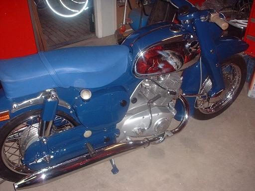

I'd say stop looking for C71/76 front pipes and have them made at an exhaust shop or something like that, they have a real easy bend an common diameter.
New ones will also look much better when chromed.
I have had mine replicated to a rusted through example, and it came out great.
I can supply the old one to anyone who's interested? (pm me..)
The shop that did the work for me was london-exhaust in the Netherlands, cost me 150 euro's for a new set (that's not expensive in my opinion)
This is my C71 nearly finished, those are the pipes they made for me (and yes, i know the badge is the wrong side...)
