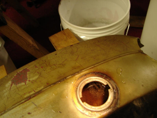

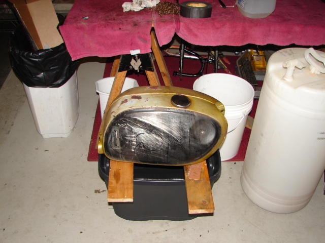

For lack of anything better to do (till payday when I can order some tranny parts) I got my spare tank out -shook it for a while with a handful of short chain lengths inside, and set it up with the milkstone remover. I have had good results with this before. I may have to do this twice this time. I dont know how much crap I loosened up. Anyway, here's a picture of my setup. Pretty basic. Plug the petcock hole with a cork, and put a lenght of fuel line on the crossover, then bend it double to kink it and give it a couple of wraps with wire to keep in kinked. Wont leak.
