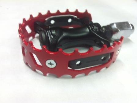

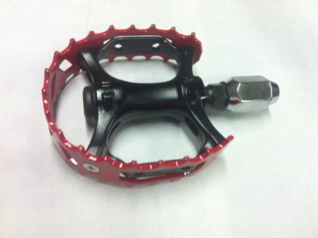

I'm sorry I know that this is an old thread but I have some questions. Where did you get that kickstarter? That is sweet! I have been looking for one like that for some time now.

The kick start is just a bear trap bicycle pedal. I took it apart and powder coated it. I then took the original kick start and cut the end off. I then welded a simple 1/2 -20 lug nut on the end; ground the edges smooth and powder coated it. I have an extra peddle that I did not use. It is also coated a little differently. Send me your address and I will send if you like. I will take a pic tomorrow.
