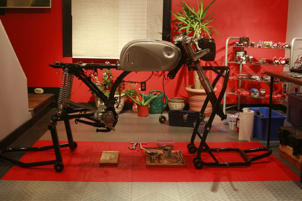

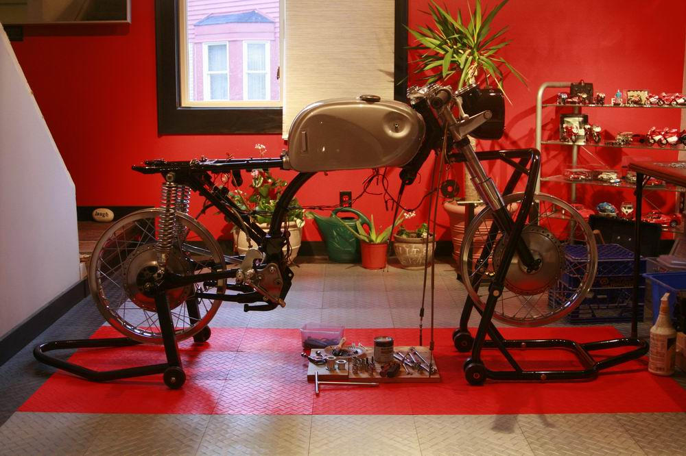

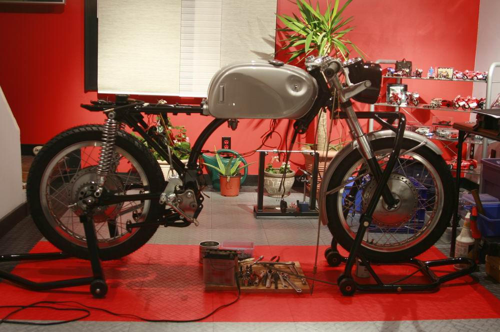

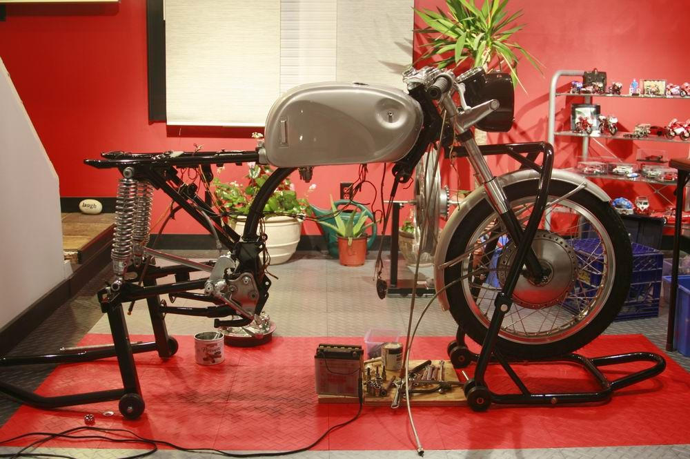

A lot has happened since I last posted.
1. zinc plated hardware
2. rims laced
3. tires mounted
4. tank and front fender painted
5. cb160 front fender drilled & mounted

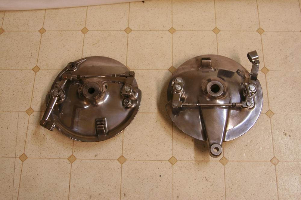

6. brakes assembled
Pics attached
rear tire/rim/brake mounted
front fender mounted, front tire/rim/brake
assembled brakes
assembled brakes

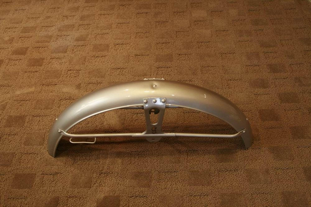

CB160 front fender - fresh paint.

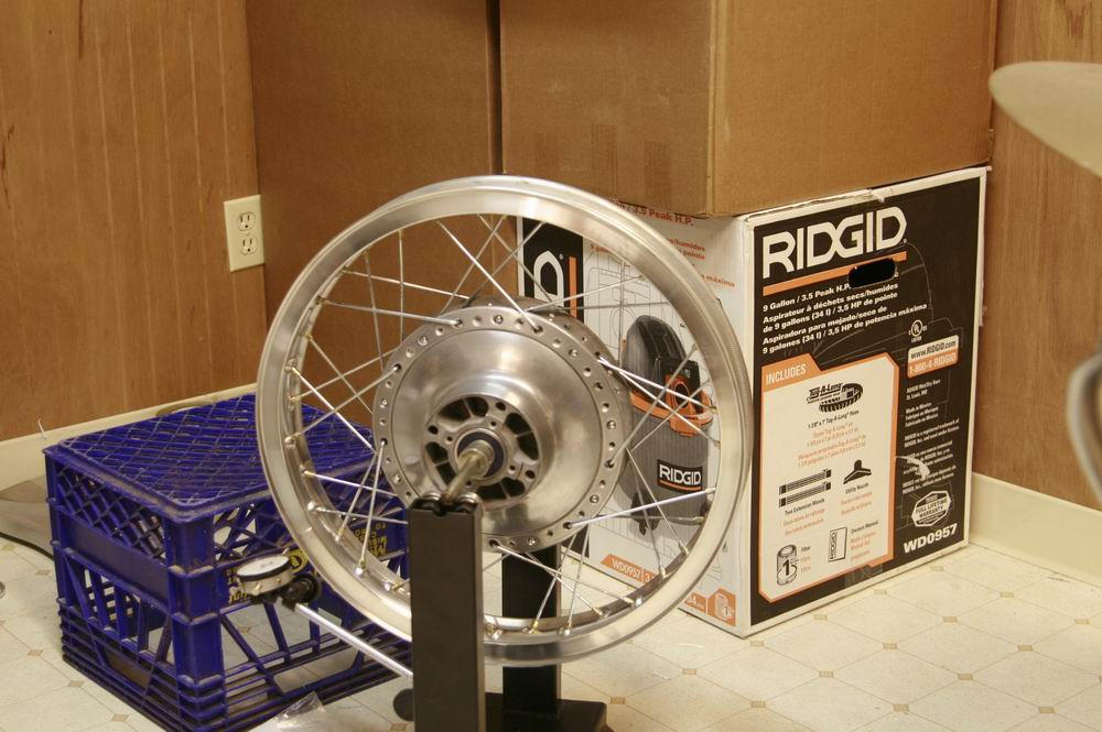

rims laced and fitted
63 cb77 cafe
www.eyhonda.com

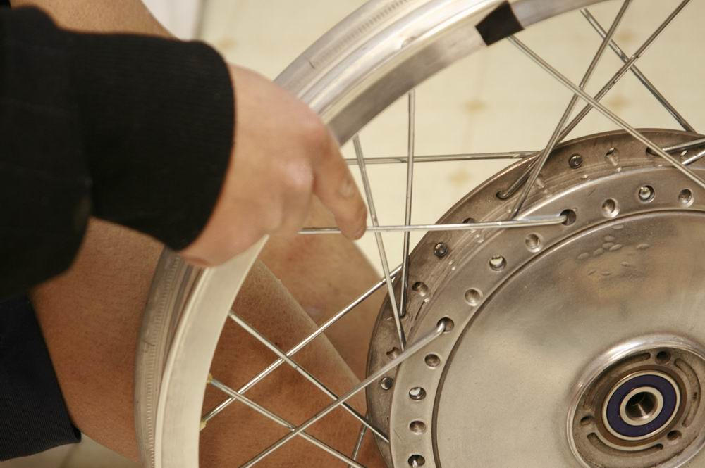

Here are a few shots of my son lacing the front and the laced rims.

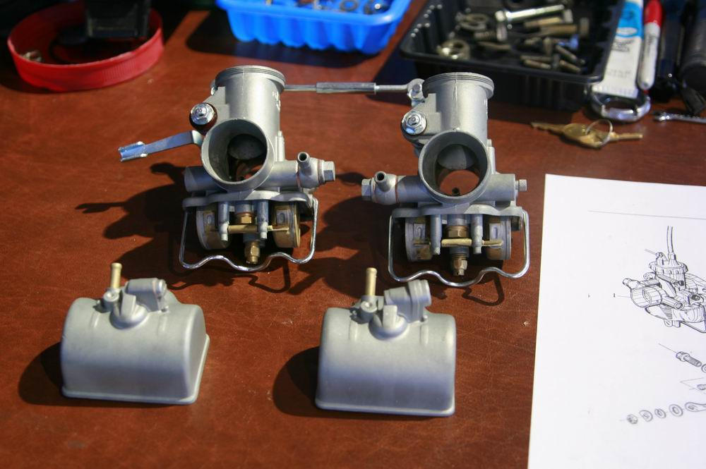

Carbs built
Post by eyhonda » Mon Apr 19, 2010 1:07 pm

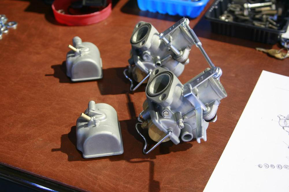

I've built the carbs. Pretty straight forward.

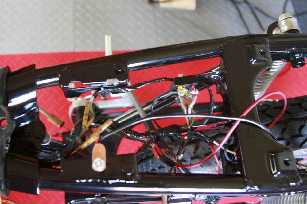

electric work
Post by eyhonda » Mon Apr 19, 2010 1:13 pm

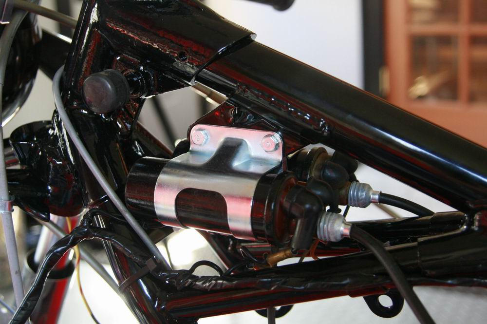

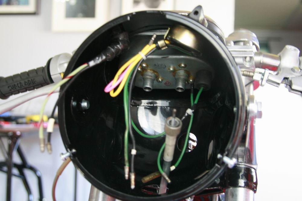

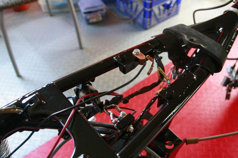

Electric was not so bad. I made a few mods. The rear running light (white) is connected to the switched battery (green). The hi-lo switch was bypassed and the headlight switch is used to turn the light on or off. I won't be riding too much if at all at night. I've removed the starter circuit all together but the starter (yellow/red) is still intact if I want to add it later. The battery is smaller (3ah).

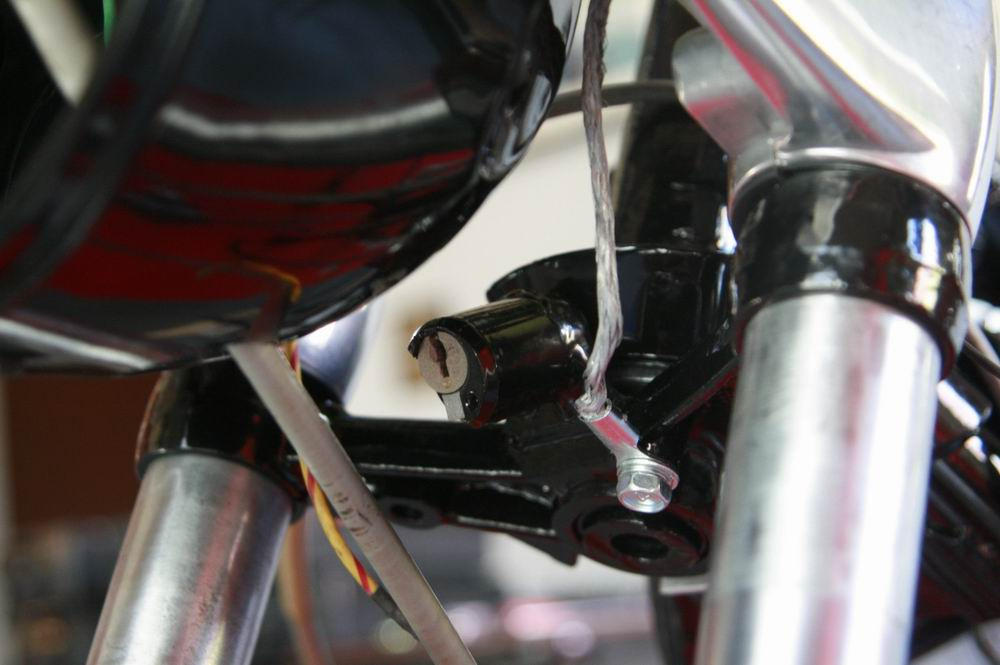

Ground strap for headlight to ground.  The headlight brackets are insulated.  So this was needed.
In the shell.
In the shell.
the coils
the coils
top view of main area
