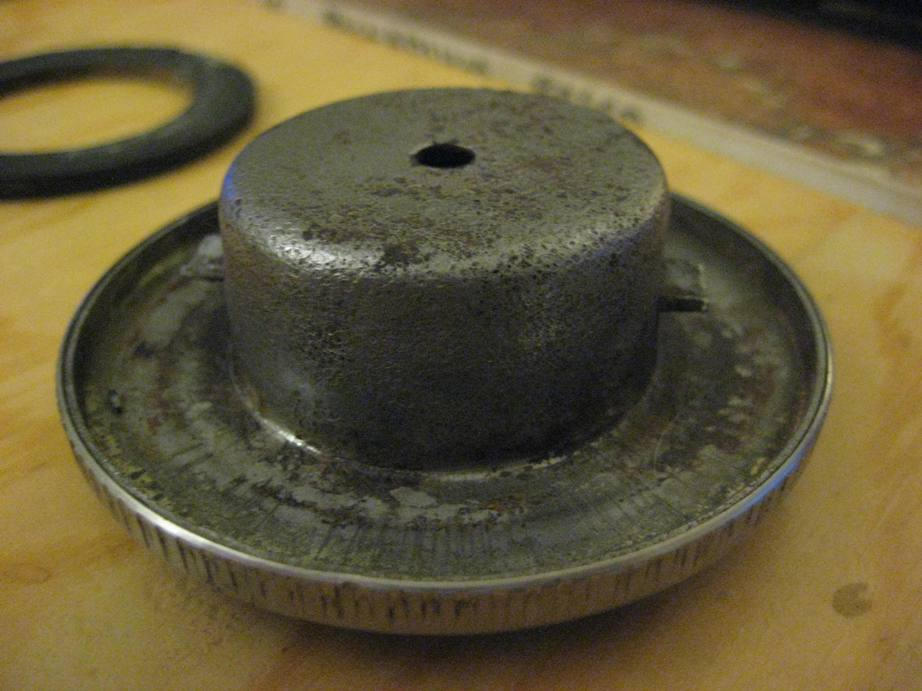

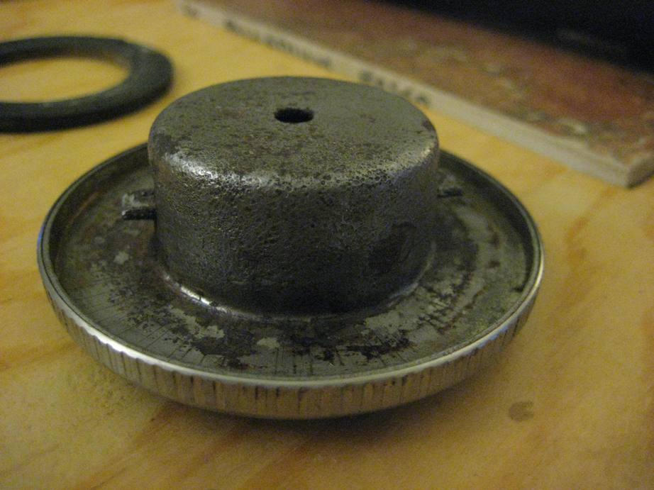

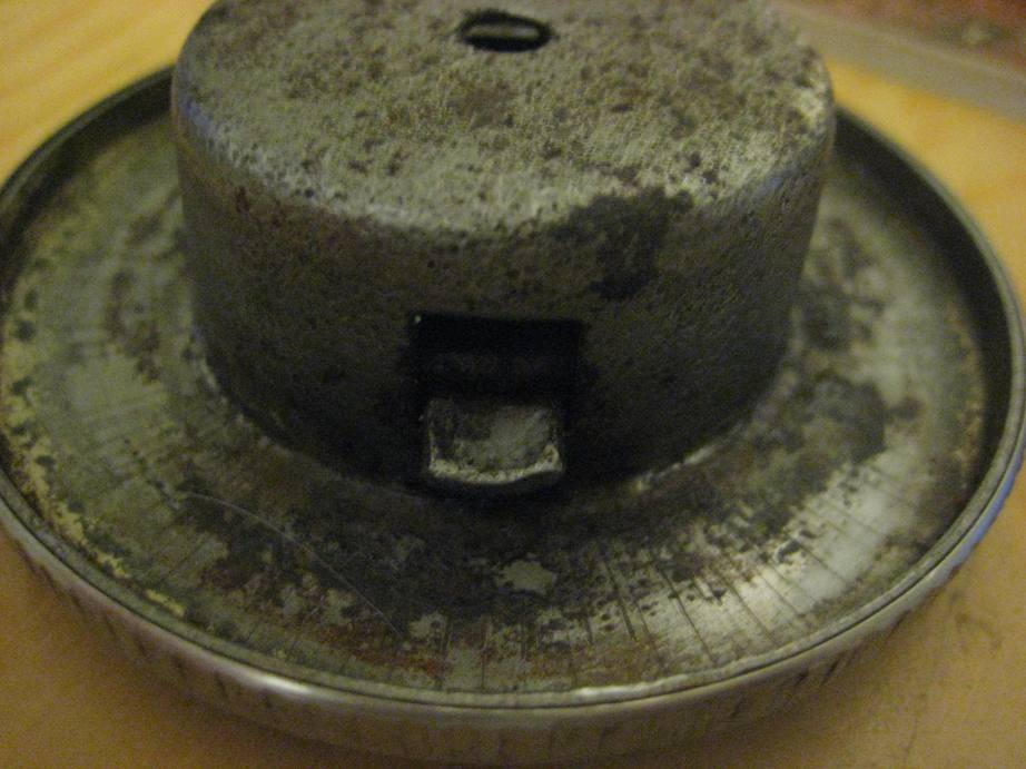

I read through this thread trying to find an answer to my own problem. My gas cap is not venting, and danged if I can find any vent hole on the underside of my gas cap at all. I was getting some very expert help with my clutch earlier (thanks LM!) and went out for a ride only to be stymied by a bad gas cap. Here are some pics with the rubber gasket removed. Where should this vent hole be? Is this the wrong cap for my bike perhaps? I'm showing the underside of the cap from 12 oclock, 3 oclock, 6 oclock and 9 oclock. Oh, and I'm taking this opportunity to clean this cap up a bit with some steel wool...

The closest thing I can see is in photo #2 on the right inside edge of the cap, as it appears that there's a hole there. The vent hole is a teeny-tiny hole, and you should be able to see it with the gasket on (the gasket does not cover the hole).

you're right it looks like a hole... but it ain't it's just a speck. So that's where the hole is supposed to be? Just inside the lip like that? I promise this cap doesn't have them. So it is possible to split the two halves of the cap? maybe I should try that and drill some vent holes in the inner cap?
