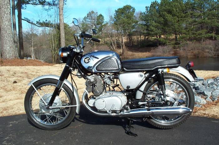

cyclon36 wrote:Going through the exhaust bits. I took the headers off to clean them up a bit. I noticed a big weight difference between the two. Upon inspection I realized that one side had an inner steel tube while the lighter one did not. Was this common or do you think one side is aftermarket and one side is stock?
Mine (thankfully!) has a pair of twin-wall headers; I think these were OEM. It's to stop the chrome 'blueing' like a poxy piece of old BSA or Triumph Britshit. I can say that. I used to run both.
Link to a pic of my original CB77; no blued headers!
Incidentally, I'm wondering if your handlebar may be from a CA-model. A riser 'bar of that height wasn't USA-market, I believe. Canadian CP77, yes; but it didn't have the concealed throttle cable á la CA. In which case, do an eBay search for a CA72 or CA77 for non-US market r/h switch (Europe, Canada, domestic Japan).
Keep the questions coming -- we have most of the answers.......!!
Canadian CP77 pic:
