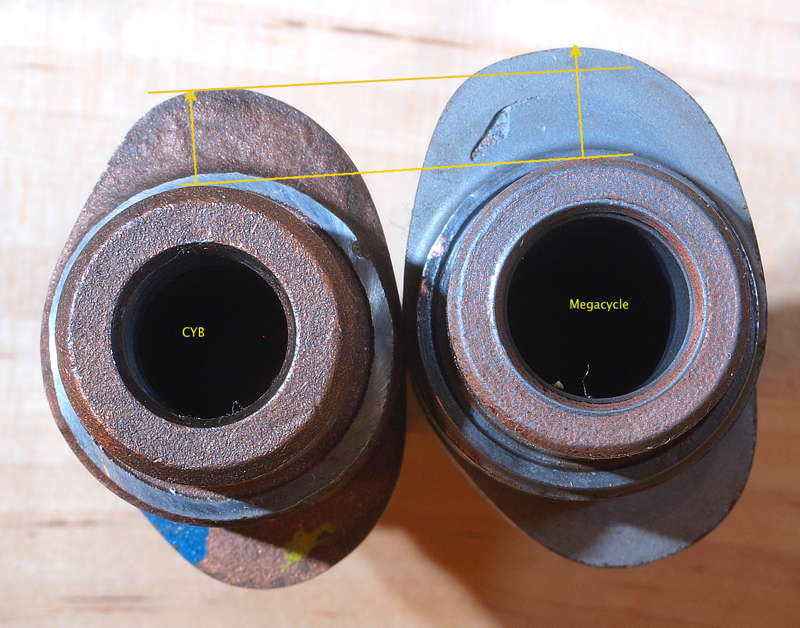

Now if you had some like this, you could have real fun. If you look closely at the Megacycle Cam you can see the original profile that they've built up.

Are you saying that your OEM cam also has the Intake/Exhaust the same (they look the same in your photo)? Was the Megacycle Cam suppose to be a direct replacement for the OEM? Looks a lot taller.

Despite the photo, I haven't actually measured them. The CYB is a genuine Honda 'race kit' cam and the Megacycle one is their top race cam for CBs.
I'll get some dimensions for you.

My Megacycle 12120 cam has the following spec
Lift Intake 0.330" Exhaust 0.330"
Duration 325deg 317deg
Largest dimension 32.47mm 31.73
CYB - Honda Race Kit cam
Largest dimension 31.59 31.21
Don't have any lift figures for the CYB but the duration is much shorter than the Megacycle. Interesting that the Magacycle claims identical lifts but the lobes are different heights.
