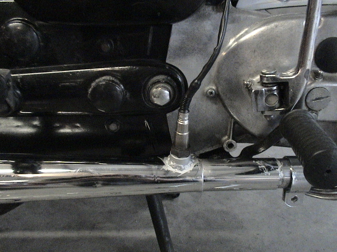

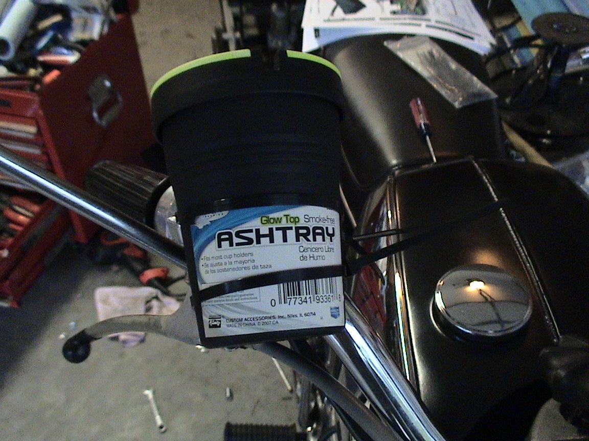

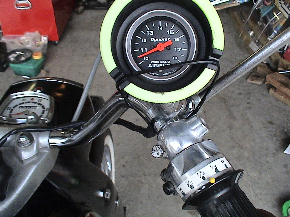

Work in progress......don't laugh, it's all temporary, then on to another bike.
Decided against riding down the road with a bunch of wires hanging out of the tailpipe, so a trip to the local muffler man netted a bung, plug and weld-in job for $10.00.

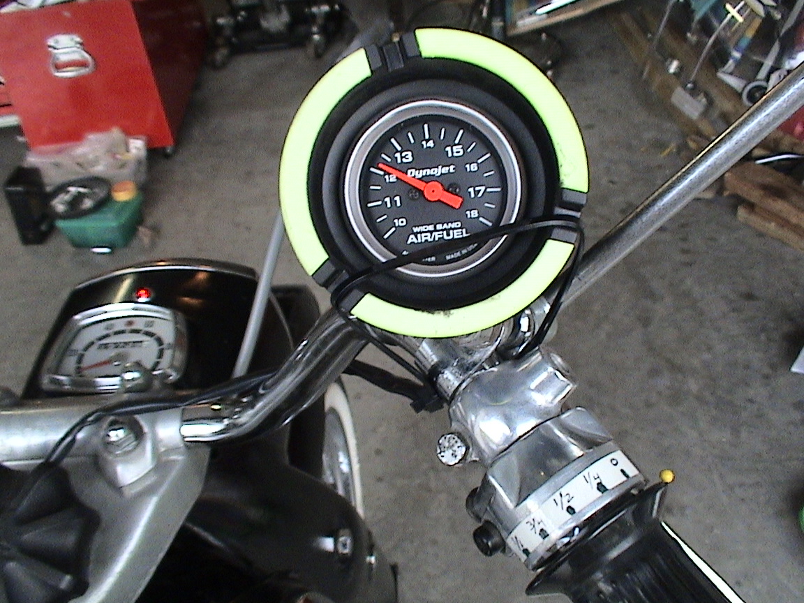

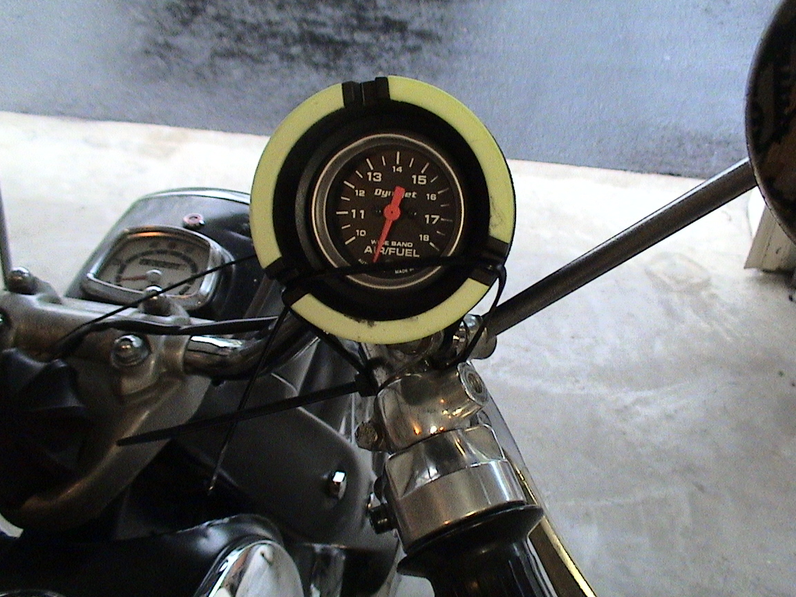

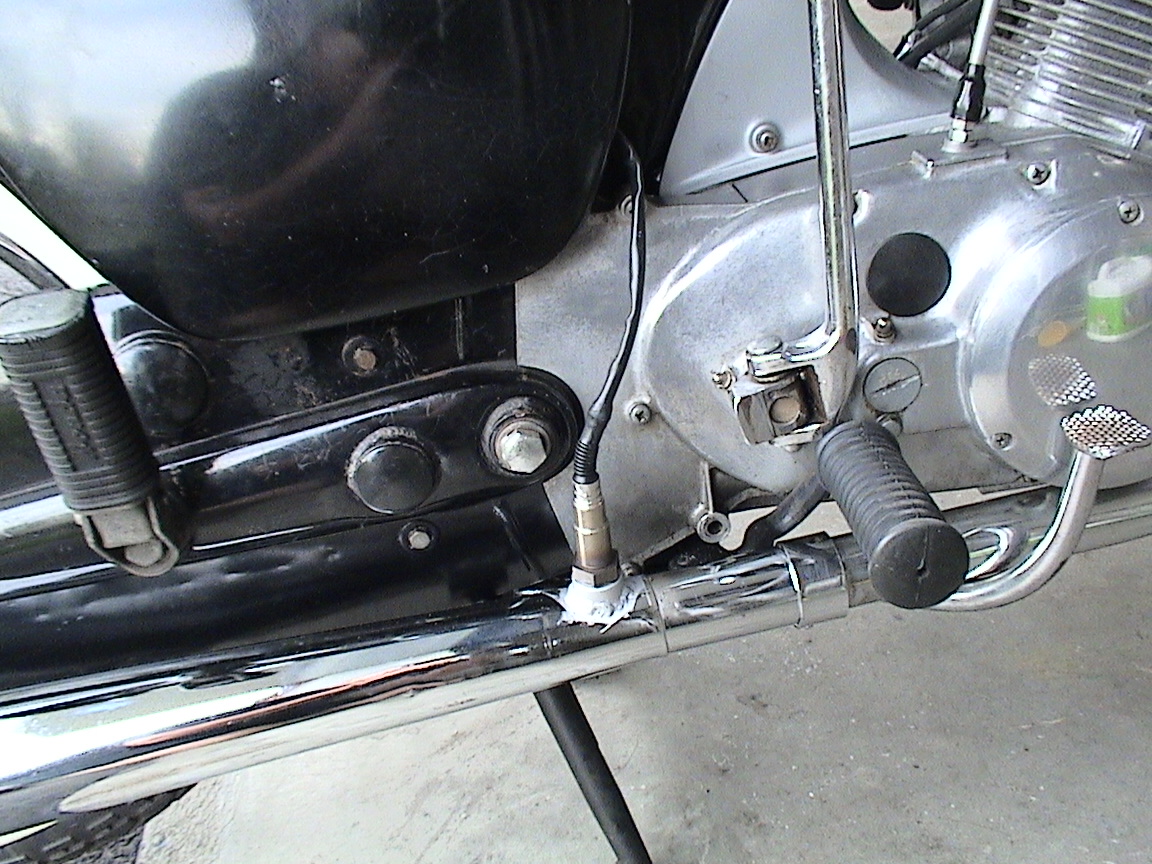

Stage 1:
Got the meter operational (no RPM read or Data Logging hooked up yet).
Haven't had a chance to road test, or even check for exhaust leaks yet either.

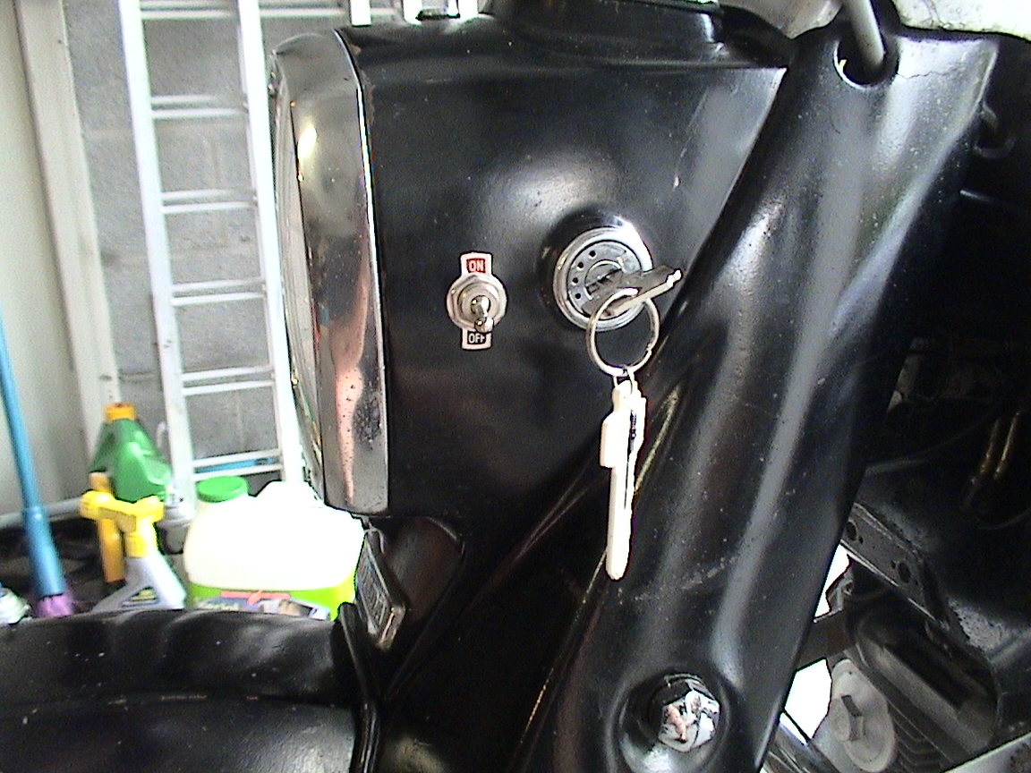

I installed a cut out switch for the headlight, so I could run full magneto power (Ig Switch on lights position) and turn the HL off, and run the meter, box and heated sensor off the HL circuit.
I was going to do this anyway, since the dimmer switch has no middle "off" position on mine.
Pics:

Finally got a chance for the first road test today.
Some initial observations:
Steady state idle........11.5 A/F ratio
Just off idle to 1/4 throttle jumped around from 11 to 13.5
Steady uphill load, steady speed:
1/2 throttle............11.5
3/4 throttle............12.5
wot.......................11.5
It was also interesting that under steady load, wot, A/F, as the bike slowly increased RPM, got leaner with RPM increase.
Also, on decel the A/F really got leaner. but rarely past 16.0.
These numbers are from memory, so are subject to verification.
