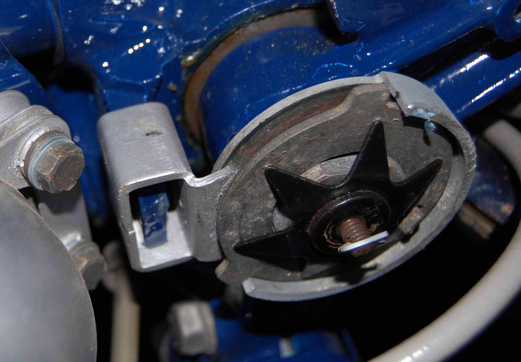

I'm about to reassemble the forks and the steering stem, but I can't remember which order the parts were in. The part manual isn't too much of a help to me. Just a number of ambiguous pen drawn disks. In reference to jleewebb's photo, I can't tell if there's an additional part that's cupping the bearings or if they just rest within groove, held in place temporarily by grease.

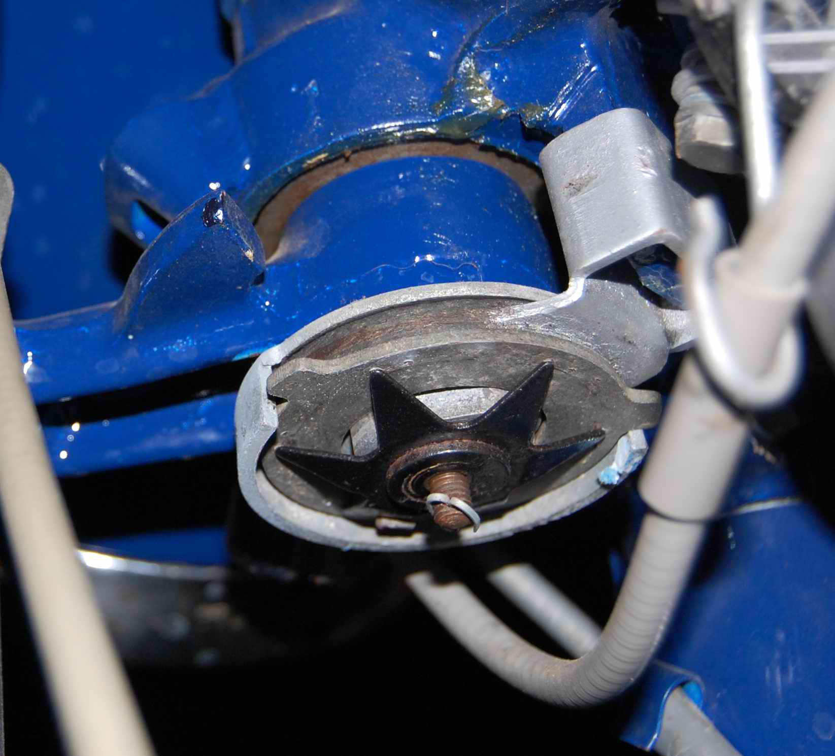

Ball bearings are just held temporarily with grease, stick a finger full or so of grease up into top-lower race and shove it together. I seem to remember there's a rubber washer/grease seal, then a thin metal washer under the bottom-lower race. So order from bottom would be washer, seal, bottom-lower race.
Hope pix below help explain steering damper, looks like you've got upper part upside down.
Glad to see your bike coming together, keep us posted. --Lee
View from left side.
View from right side.

Parts manual is confusing because it doesn't show what I'm calling the top-lower race, which is up inside frame. Part #2 is bottom-lower race, part #3 is upper race at top of steering stem, with race under that also not shown. Hope I got this right...--Lee

Ahhh, I see... makes perfect sense. Thanks a ton Lee. A photo is easily worth a thousand words!
