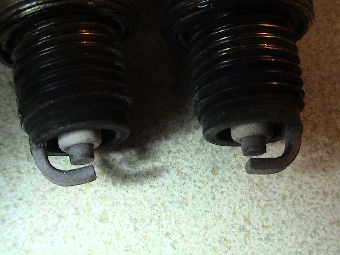

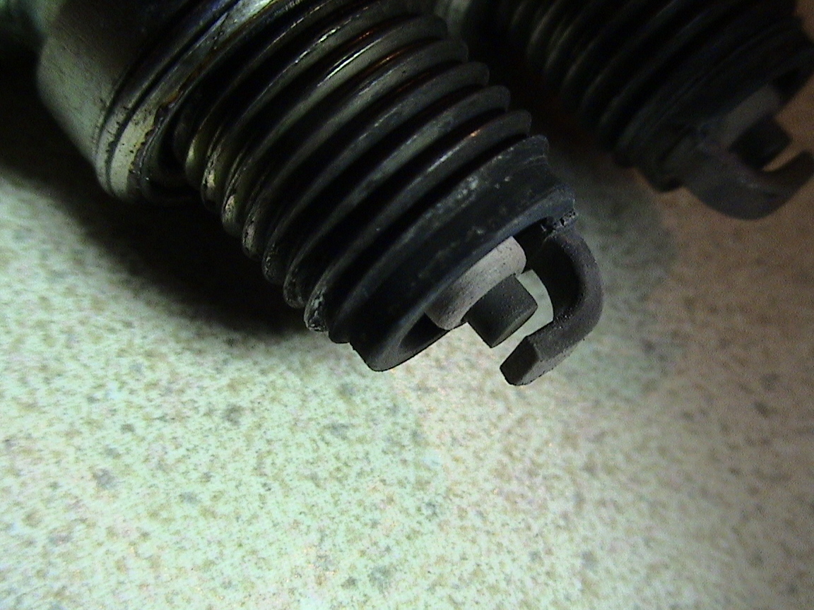

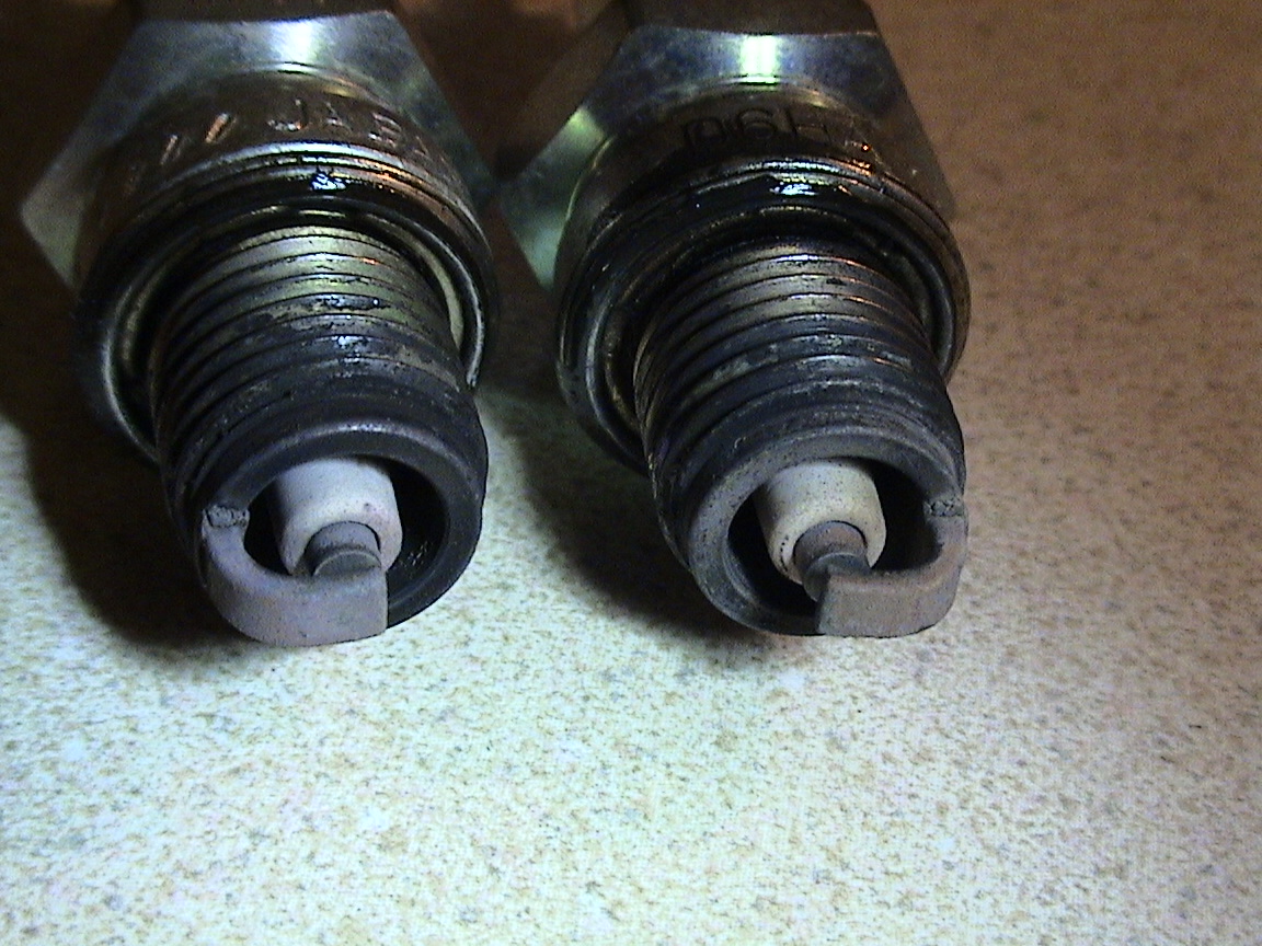

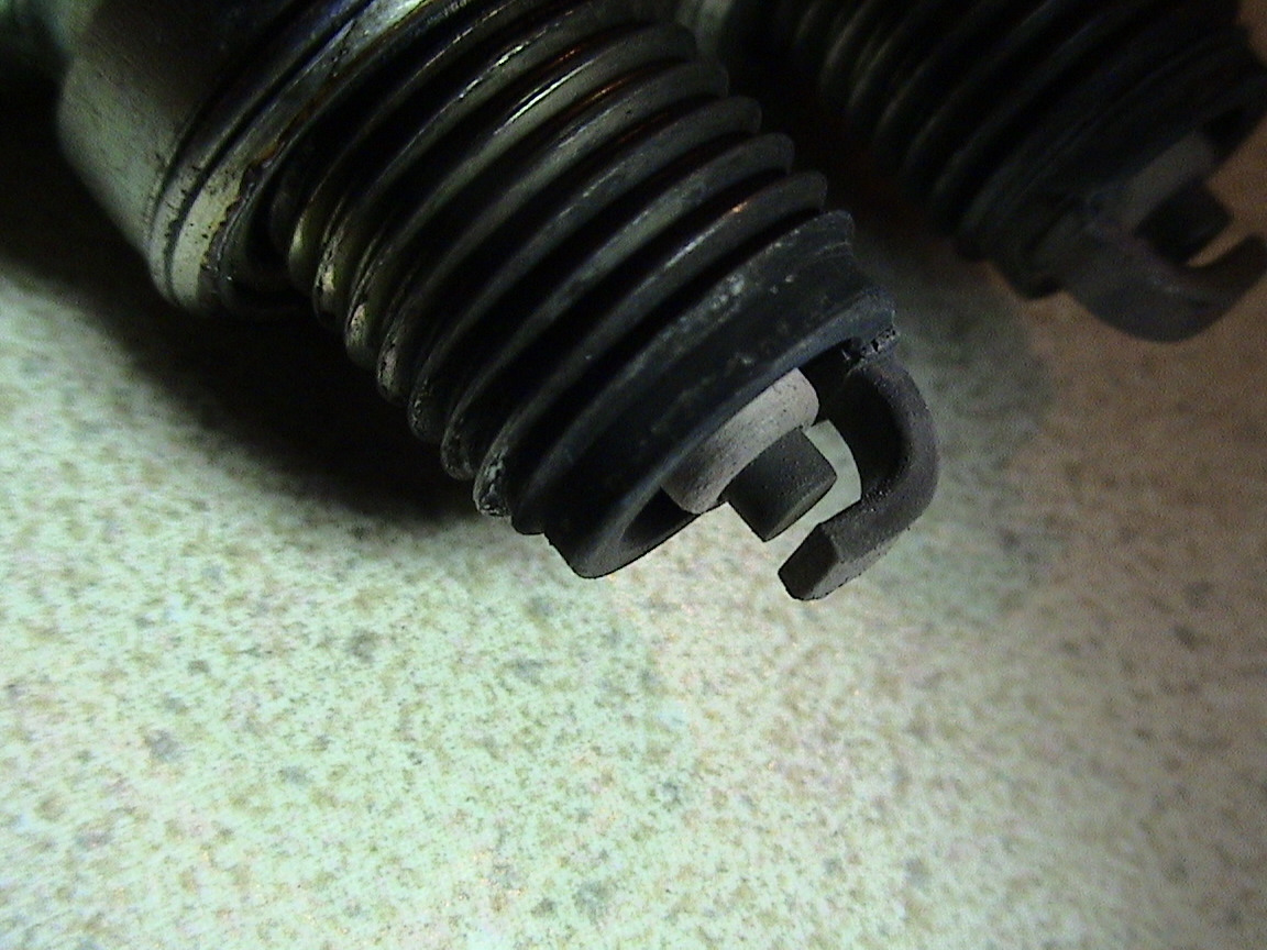

Pulled the plugs after the 45 mile run (not chopped):
